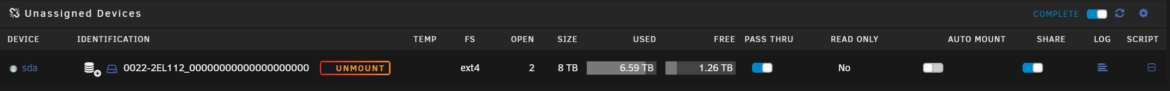

Hi everyone, I know this has been asked a couple of times, but I am still not sure I get it. I used to have an UBUNTU 18.04 LTS server with manually configured SMB shares, Webmin etc. I now moved to UNRAID (today).
My NAS is an AMD Ryzen 3rd Gen 5 3500 CPU, 32GB RAM and ASUS ROG B450-I motherboard, 2 x brand new 14TB IronWolf SATA drives, 1 (fast!) NVMe 512GB
Before moving to UNRAID, I backed up my data in Ubuntu to the external USB 3 drives (I use the ORICO SATA 3.0 HDD Docking Station). Transfer speeds for large files were around 220 MB/s on EXT4 format.
Now, I am mounting the same drives with the same external dock and I am getting around 32 MB/s... I saw some people in the forum saying "that's normal, overhead, array, etc.", however my array is essentially "RAID0", no parity disk.
Q1: why is this? Is this a caching issue? My thought would have been that using the SSD cache would speed up things. Am I wrong?
Q2: how can I restore my data at 200 MB/s to avoid spending weeks?
Thanks!
