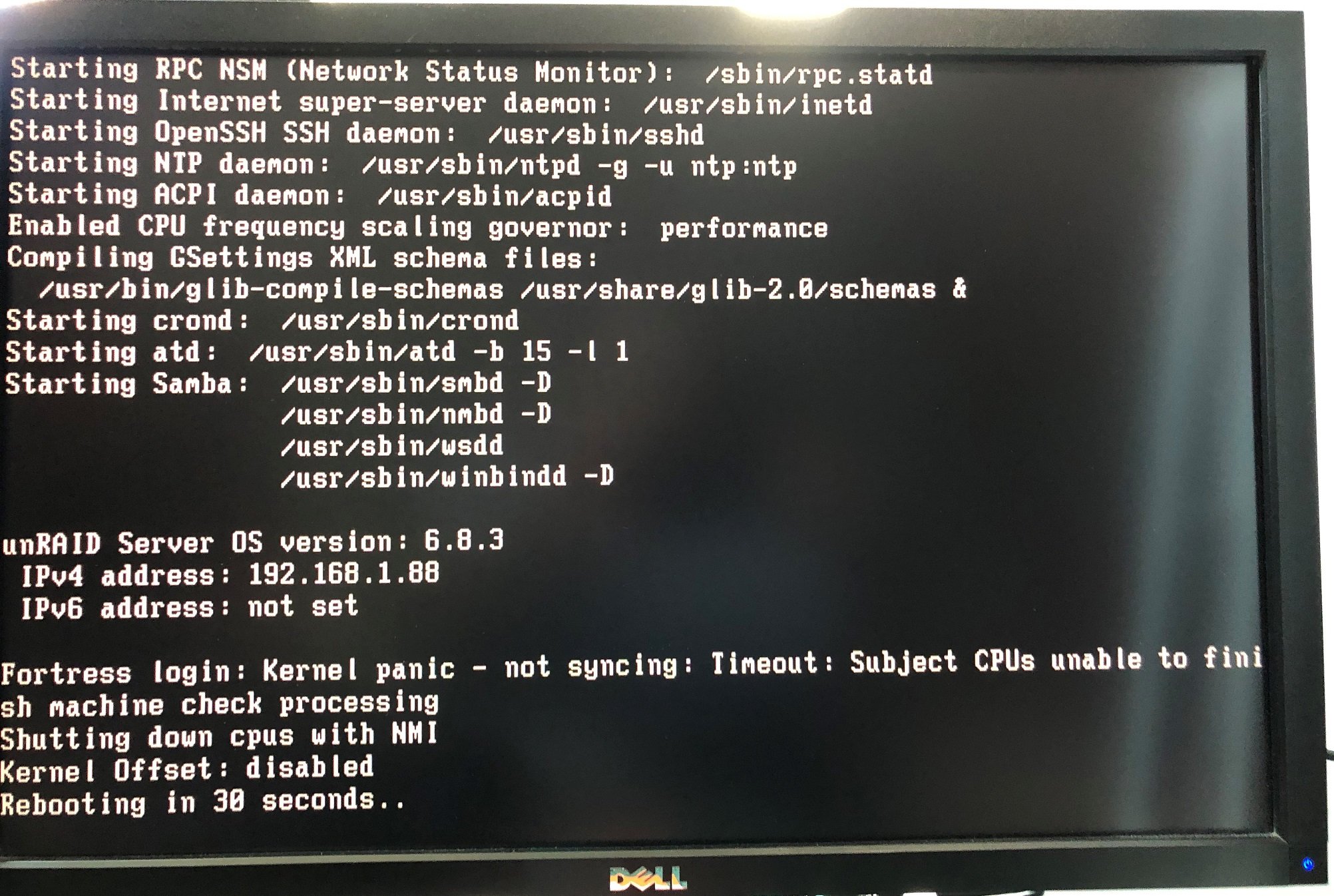

I did a hard reboot, there was a kernal panic but I i didn't get a pic of it, something to do with a CPU sync.

I tired earlier but there was no response. Doing the hard reboot worked, parity didn't finish and it started again.  But as I write this this popped up - is that what I think it means - need to replace the CPU?
