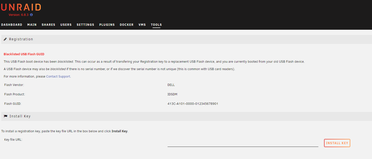

Blacklisted USB Flash GUID
My DELL IDSDM is Blacklisted.
Can you help me?
There is lot much you can do other than use a device that is not blacklisted :(   Limetech do not have any procedure for un-blacklisting a GUID  (I know as I asked when I accidentally ran the licence transfer process against the wrong flash drive thus blacklisting a perfectly good one) .  It is a requirement that Unraid is run from a device with a unique GUID.   This means you cannot use devices where the manufacturer has not given each of them a unique GUID which it looks like what is happening in this case.

in theory that should not help as the GUID is built into the hardware.
it can happen after an upgrade if the device appears to have a valid GUID when Unraid is first installed,  but it later turns out that this is not the case when more than one user tries to register the same GUID.  In such a case it is only when the upgrade happens that the new blacklist kicks in and you get the message.
