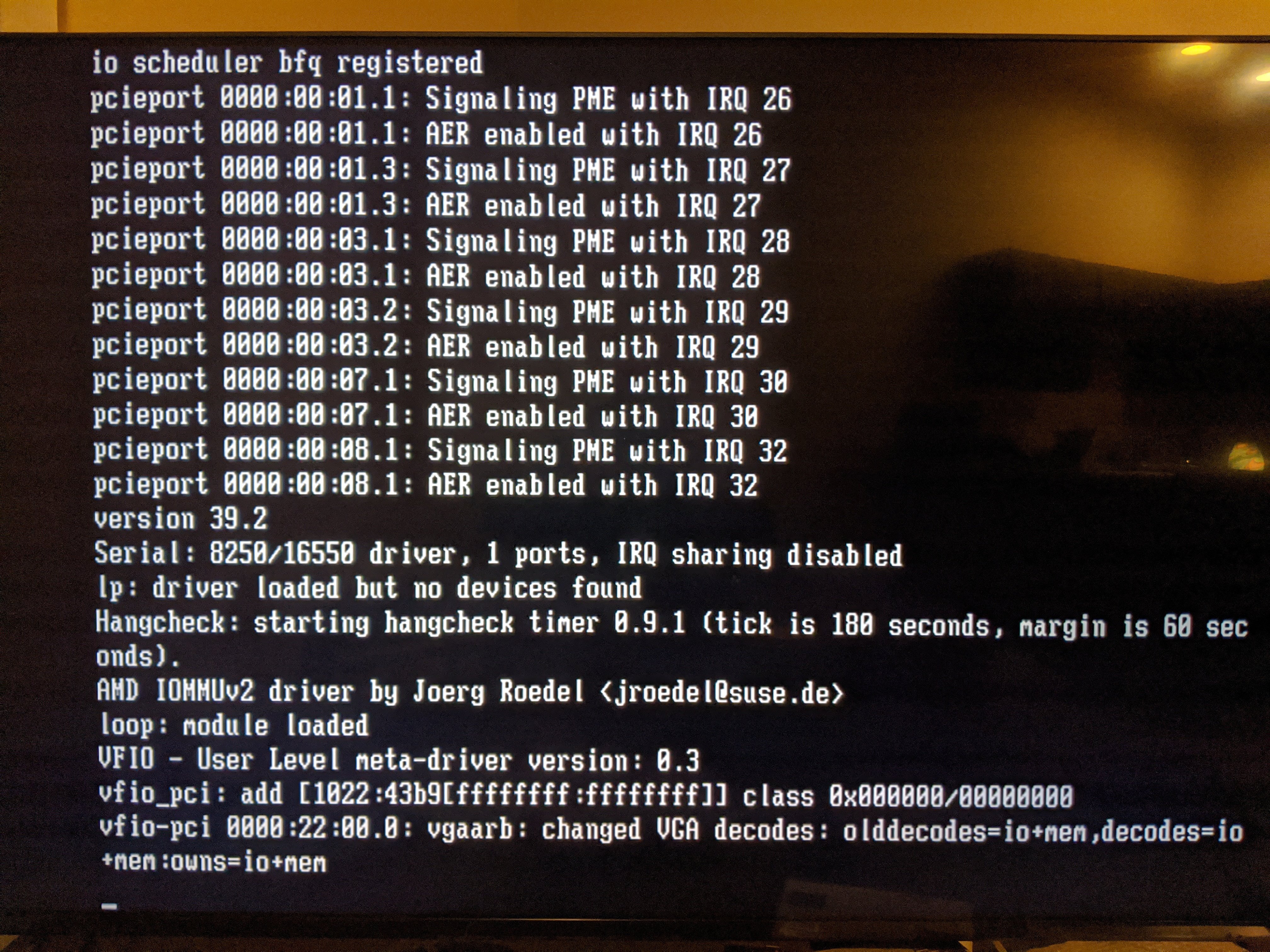

I also tried adding the addresses for the GPU and associated audio to vfio-pci.ids=, but this caused unRAID not to fully boot and it got stuck at the screen in the attached picture.

Are you saying to add the addresses(from system devices) to the vfio-pci.ids= line in the syslinux file? If so, I tried that but the server wouldn't boot and got stuck at the point in the original screenshot. I also tried using the 'VFIO-PCI CFG' plugin to bing the device, but that resulted in the server getting stuck at the same point in boot up.

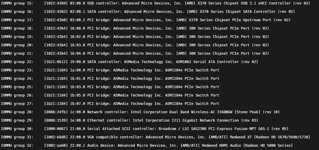

I'll add some screenshots to hopefully help visualize this. With ACS override set to Both, system devices shows the following. The USB controller and GPU/audio I want to pass through are in groups 15, 31, and 32...

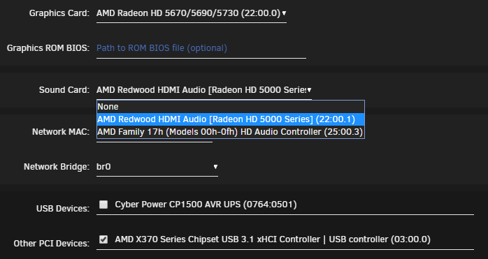

I add the GPU/audio and USB controller to the VM form as shown below and click Update.

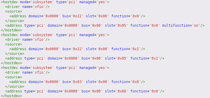

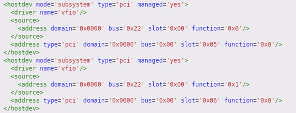

The resulting XML is below and looks to be correct...

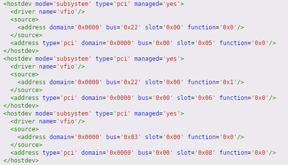

I then add multifunction='on' to the 6th line and update the slot and function on the 13th line for the audio. This is shown below...

I also tried adding the GPU/audio IDs to the syslinux config as show below, but this prevented the server from booting and it got stuck at the screenshot from my original post.

Update: The good news is that the server is not failing to boot after adding the GPU pci ids to the vfio-pci.ids line in the syslinux config. I just needed to wait longer for the server to boot and come back online.
The bad news is I'm still having the same issue...The video output for the VM is not displayed on the monitor. Also, after starting the VM, and also stopping it later, the server will not respond to a shutdown/reboot and I need to hardboot it to get it responding again.
