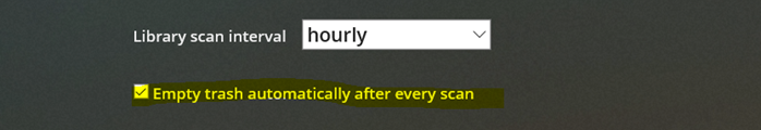

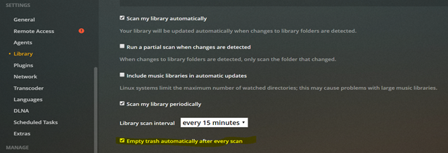

1.     In the Plex webUI, open the settings and uncheck ‘empty trash after each rescan’. Then save.

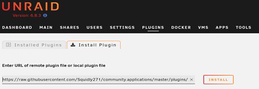

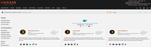

6.     Next we need to setup a Docker container on Unraid that will be our new Plex media server. I used the ‘Community Applications’ plugin by Andrew Zawadzki to make this easy.
7.     From the Plugins section in Unraid, just add the Community Applications plug-in
like this:
8.     The URL to use is:
https://raw.githubusercontent.com/Squidly271/community.applications/master/plugins/community.applications.plg
For more information, please see the Unraid forum post:
https://forums.unraid.net/topic/38582-plug-in-community-applications

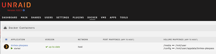

9.     Once installed and started, you should see the below in the Docker section of Unraid.

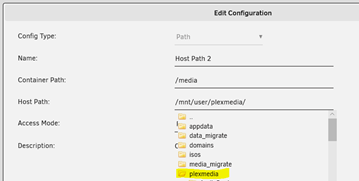

10.  In order to map the right container paths to where things are stored on the Unraid directory, we need to change the host path as shown, and then save and apply.
11.  Notice that /config is mapped to /mnt/user/appdata/binhex-plexpass, as shown below:

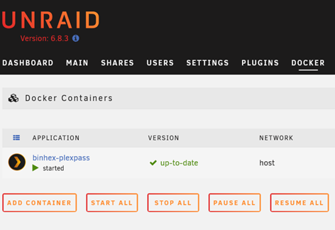

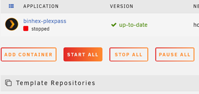

12.  This is where the new Plex metadata resides. We will need to overwrite this with the data we transferred over from FreeNAS. First stop the container that is running using the UnraidUI – click the STOP ALL button:

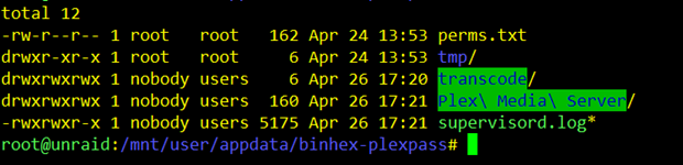

13.  Using the terminal shell on the Unraid host, go to the location where the plex configuration data resides:
root@unraid# cd /mnt/user/appdata/binhex-plexpass
14.  We need to rename the existing Plex Media Server Directory that is already here.
root@unraid# mv "Plex Media Server" pms.old
15.  Now we need to move our FreeNas Plex configuration (that we transferred from FreeNAS previously to the ‘backuptars’ directory) to take the place of the Plex Media Server directory we just renamed. NB. The reason why we move it here instead of maybe just changing the volume mapping of the docker container, is that future updates of plex may expect certain things to be in certain places… it may well work, but I didn’t want to risk it...
root@unraid# mv /mnt/disk1/data_migrate/backuptars/PlexMediaServer_backup.tar .
16.  And then we need to untar the file so that we have the Plex Media Directory recreated.
root@unraid# tar -xvf  PlexMediaServer_backup.tar
17.  And then adjust file and directory ownerships:
root@unraid# chown -R nobody:users "Plex Media Server"
18.  Now start the Unraid Plex Docker container by clicking the START ALL button:

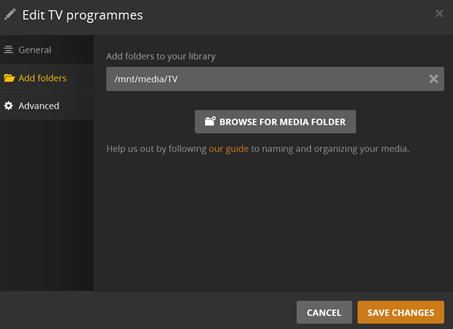

21.  This is because the path to the media (as known to Plex from your old instance on FreeNAS) has changed and Plex can no longer find the actual media file to serve. I thought this could be fixed with putting in some symlinks, but this didn’t work for me. So, I just manually mapped my media directories in the PlexUI like this:
22.  Press the BROWSE button and browse to the location of your media – for example, for my TV media, it was /mnt/media/TV
23.  Plex will rescan the library (which may take a while to complete) and the media should now play. Remember to do the same for all your other media folders, Movies, Documentaries, etc.
24.  Finally, re-enable the ‘Empty trash automatically’ feature in SETTINGS>LIBRARY in the Plex webUI and click SAVE CHANGES.
