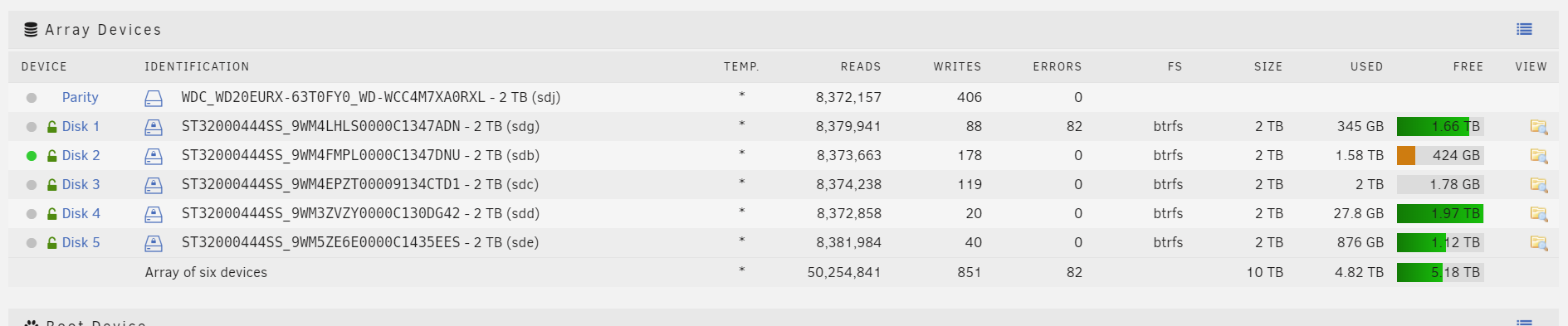

No SMART logging on my SAS drives?
Disk 2 is showing read errors:
But I can't get any stats out of the SAS drives?  Log attached.
Presume its a failing seagate, worried all of these are about to pop now.  I've just spent the last week copying data back and fourth and rebuilding parity ready for a case upgrade. Potentially stress tested them all rather more than they are used to.... =/
ST32000444SS_9WM4LHLS0000C1347ADN-20200426-2009.txt
It's a known issue with smartmontools on latest release and some SAS devices, it will work if you downgrade to v6.8.2.
This server maintainance has sure been a faff these last two weeks :D Made up for years of plain sailing mind.
So I rolled back to Version: 6.8.0-rc7 (that was my option), and I can only upgrade to 6.8.3 when I select stable branch, is there a way to choose 6.8.2?
6.8.0 is not happy about the forms vunerability, but the plugin doesnt appear on CA looking for sysdream and limtech, i need to look into that if i can't upgrade forward enough.
You can go to the 6.8.2 release by downloading the zip file from the Limetech site and extracting all the bz* type files to the root of the flash drive.
It is a good idea to have first backed up the flash drive.
Thanks, i'll add that to 'my list' :)

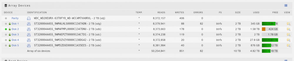

Is it still the case, it seems to be unless its another issue, that smartmontools and the unraid front end GUI still dont play nice with SAS drives?
I downgraded last time, but i've bitten the bullet and moved forward to 6.9 so I can use cache pools.  Now I'm SMART-less.  Unless I manually run everything, which isn't ideal i'm sure i'm not the only person missing SMART on the webgui? Although it might be my fault, i might have set something else somewhere.

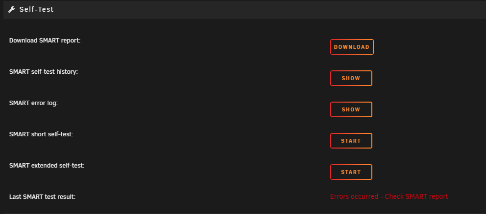

I am using Seagate ST2000NM0023 drives. They are older and I have a couple newer drives in my test server. I ordered on the way for testing. The drive identity says Available - device has SMART capability. I included a screenshot of the self-test section along with the smart report.
ST2000NM0023_Z1X1AD7B_35000c50057a953f7-20210406-1756.txt
GUI SMART tests don't work with SAS devices, but you should see the attributes, tests for SAS devices need to be done manually.
