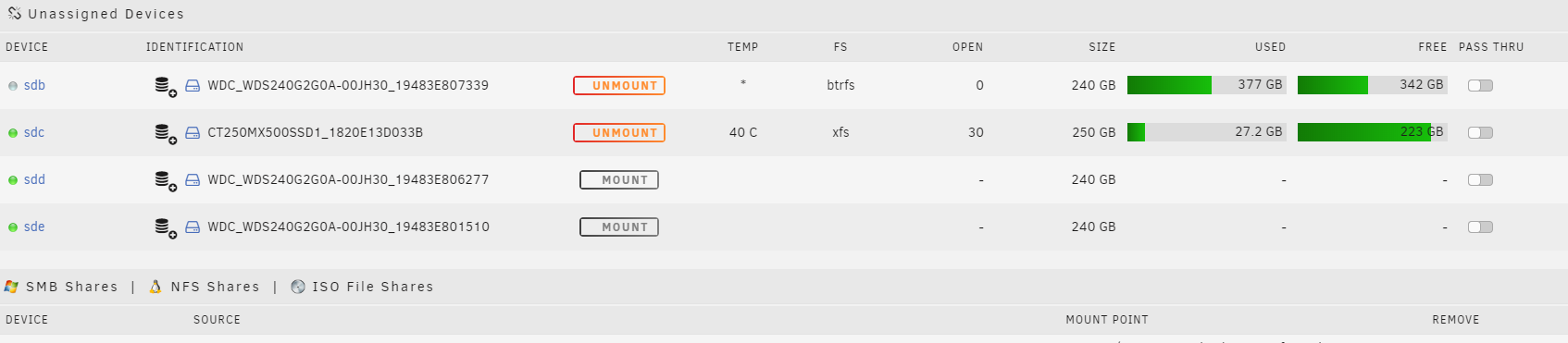

I setup RAID 0 with 3 unassigned ssd's. All seemed to go well. I tried to set nzbget to use the RAID 0 array for an intermediate directory, so I assigned another path in the docker /intermediate for the container path and /mnt/disks/test for the host path. In the nzbget settings I changed the intermediate path to /intermediate.
Not only does nzbget seem to ignore my changes but one of the drives was in the RAID and now appears to not be in the pool anymore, with this error in the system log:
kernel: BTRFS error (device sdb1): devid 2 uuid fa0f6263-8da8-4ecc-b400-2de8fdc56c6e is missing
Have I done something wrong?

Please post the diagnostics: Tools -> Diagnostics
When you first booted there was only one device for that filesystem, can't say what happened to the missing one(s) since whatever it was happened before current boot, but you then recreated the pool and it looks to be fine now, but to confirm post output of:
btrfs fi usage -T /mnt/disks/test

I don't think it was fine when I first set it up, but idk. I guess I was pretty flustered at this point so maybe I just read it wrong. I know the green light next to sbd kept going out like the disk had spun down. I have all my disks set to never spin down. And that is an ssd, so I'm pretty sure it was never spinning to begin with.
But thank you so much for your quick replies, I'm sorry if I wasted your time. I'm slowly getting all this figured out, 1 thing at a time.
Not much relate to your problem, but seems sdb not the "devid 1" of that pool, would you show this by "btrfs fi show".
For RAID0 pool in UD, pls ignore the green / grey light on the disks. ( There should be a bug, Green or not just means mount or not. For my understanding, UD disks never spin down whatever the setting )
EDIT : I got it in 1st post, anyway, best should mount "devid 1" for the pool
Edited by Benson
On 4/28/2020 at 4:35 AM, johnnie.black said:
Looks fine.
One last reply to this thread just to let you know that after confirming with you that the pool was setup correctly and configuring nzbget to use this raid 0 test as /intermediate directory my downloads go much smoother, esp the unpacking part, and io wait times are very low, usually less than 5%. Thanks again for your help.
