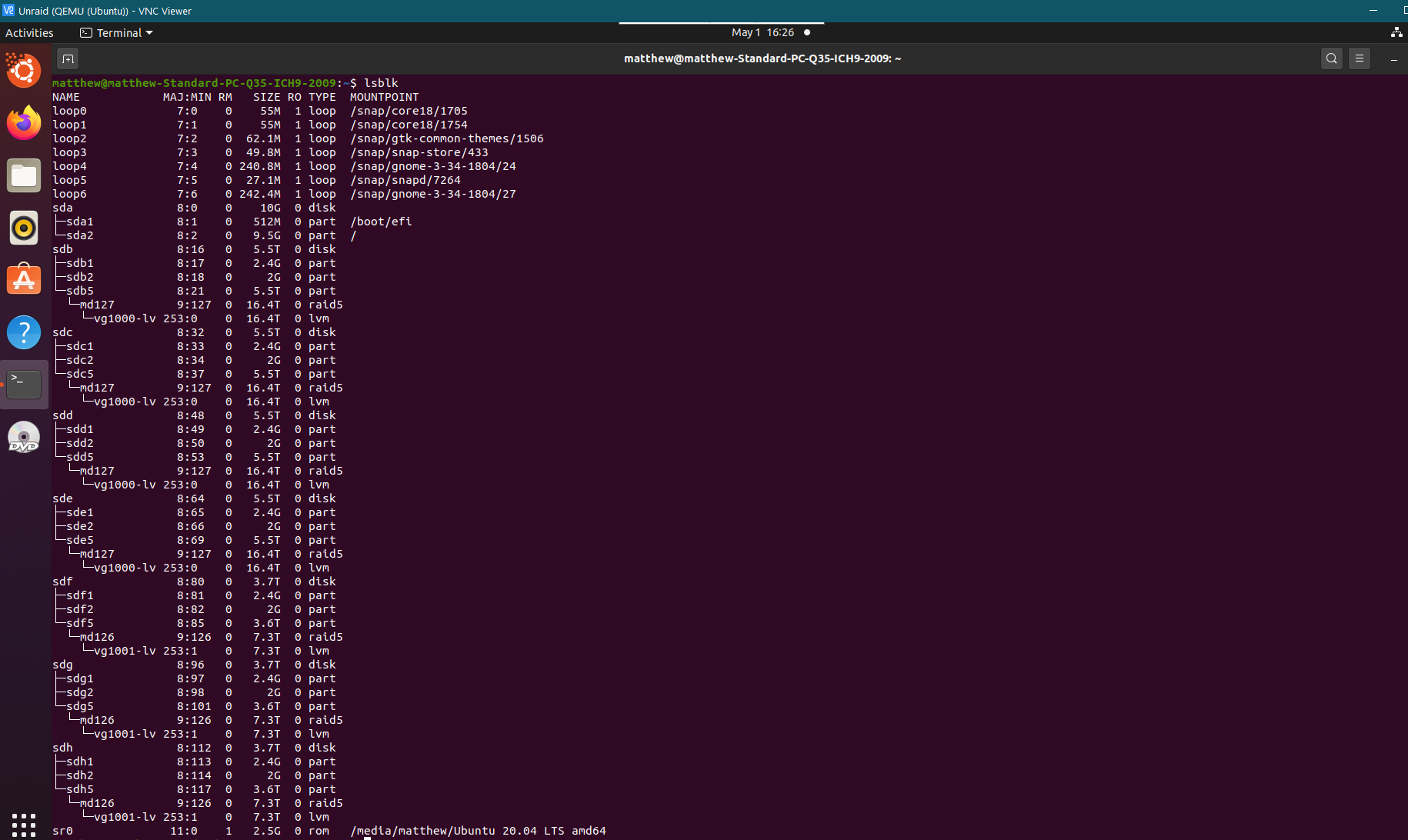

I planned to mount the Synology drives inside on Ubuntu but do it in a VM as detailed in Synology's recovery instructions
Setting up a Ubuntu VM and passing through the physical drives shouldn't be a big deal.
Create a share in Unraid where you wanna copy your data to. Depending on the amount of data you wanna recover, you need space on the Unraid array. Having the array up and running with parity already configured is the way I would go. Keep in mind, no disk in the array can be bigger than the parity drive. So don't start with a let's say 1TB parity + 1TB+500GB+250GB array drive when you wanna add bigger drives to the array anyways.
Setup the VM first without any drives from the Synology attached. Make sure it is working and has access to the unraid shares. Shutdown the VM and attach the drives to the VM. You have a couple options. You can either passthrough the controller where the drives are connected to in case you have an extra raid card or hba or you can pass them through by-id. Let me explain.
First check under Unassigned devices the ID/Name of the drives. Make sure they are not mounted and make notes for all drive members of that Synology SHR raid. For example
Open up a terminal and navigate to /dev/disk/by-id/ and list all the devices
You should see all drives and partitions in your Unraid box. In my example you see 2 entries for the drive we wanna use.
"ata-ST2000LM007-1R8174_WDZ5J72F" is the full device
"ata-ST2000LM007-1R8174_WDZ5J72F-part1" is only one partition of the disk.
You need the full drive passed through to the VM. Make notes for all the drives you need and go to the next step. Shutdown the VM and edit the template.
Click the small + button below the already existing vdisk and add the first disk. Change it from "Auto" to "Manual" and enter the full path
Again, don't passthrough individual partitions, only use the full disk ID. Repeat the steps and add all the SHR drive members. If you start your VM you should have access to all the drives and can use the Synology tutorial to recover the data and copy it to the Unraid share.

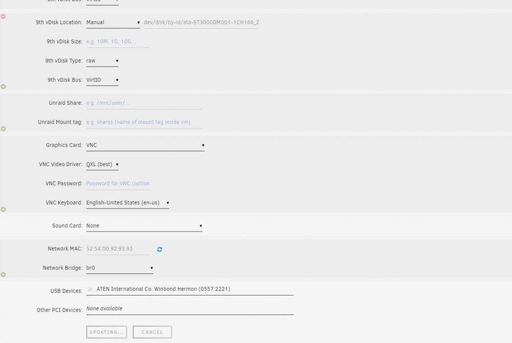

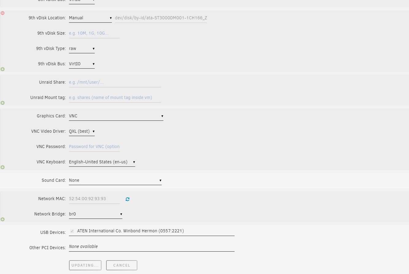

Thank you for this! I got the VM up and running, finally but cannot pass the drives yet...
Now the issue I am having is persisting settings to pass the physical drives through to the VM. When I follow your instructions above, I hit update button and it just stays there with updating... but never provides a confirmation and if I refresh the settings didnt persist. I deleted the VM and started over using the same and I am having the same issue with the settings not being confirmed. I have even restarted the server, tried different browsers. Not sure what is going on ATM. Screen shot below.
Any advice? I sincerely appreciate the community's help on this project. I am starting to get a feel for the power of Unraid but wish I could get this array mounted and transfered.
Ok so I tried to edit the xml file to mount the drives. It appeared to work for the first drive but after I added the others now I get a different error when trying to start the VM. Below is the log. Please I kindly would appreciate the help as I am trying to recover the data from this device and use unraid going forward.

2020-05-01T19:48:13.937495Z qemu-system-x86_64: -device ide-hd,bus=ide.6,drive=libvirt-4-format,id=sata0-0-6,write-cache=on: Bus 'ide.6' not found

Solution: Changed by to the form VM setting and hit update. It took the update and now the VM starts and I can see the drives in Ubuntu. Now onto the next part.
