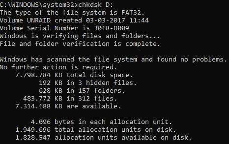

If necessary, shut the server down  (after stopping the parity check), pull the Flash drive and copy it from the flash drive on your PC.
While you have it in the PC make a complete backup of the contents of the flash drive.  Also run a   chkdsk    on the flash drive.
Here we go, complete syslog file.
I made a copy of the content while i had it in my pc as you sugested.
Ran chkdsk, nothing found:
