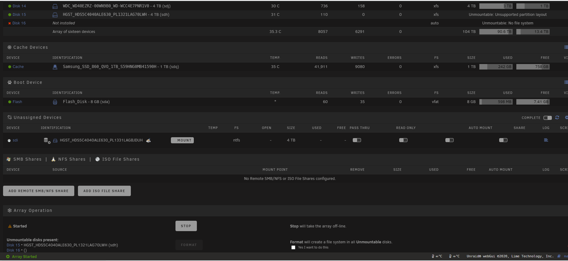

I followed the steps you wrote and I am still getting the same error on disk 15 "Unmountable: Unsupported partition layout" it also said it was missing disk 16 and to add a replacement as soon as possible. I unplugged disk 16 so that makes sense. but it did not give me the option to rebuild the data on disk 15 or recognize the partition. I am so sorry to be taking so much of your time today thank you again. I have attached the latest syslog and diagnostics.
James

I told you to unassign disk15, you unassigned disk16...
Disk16 should be clear but since I don't want to assume anything in this case, re-assign disk16 and rebuild it (it will still show unmountable), when the rebuild finishes unassign disk15 and start the array, then post new diags.

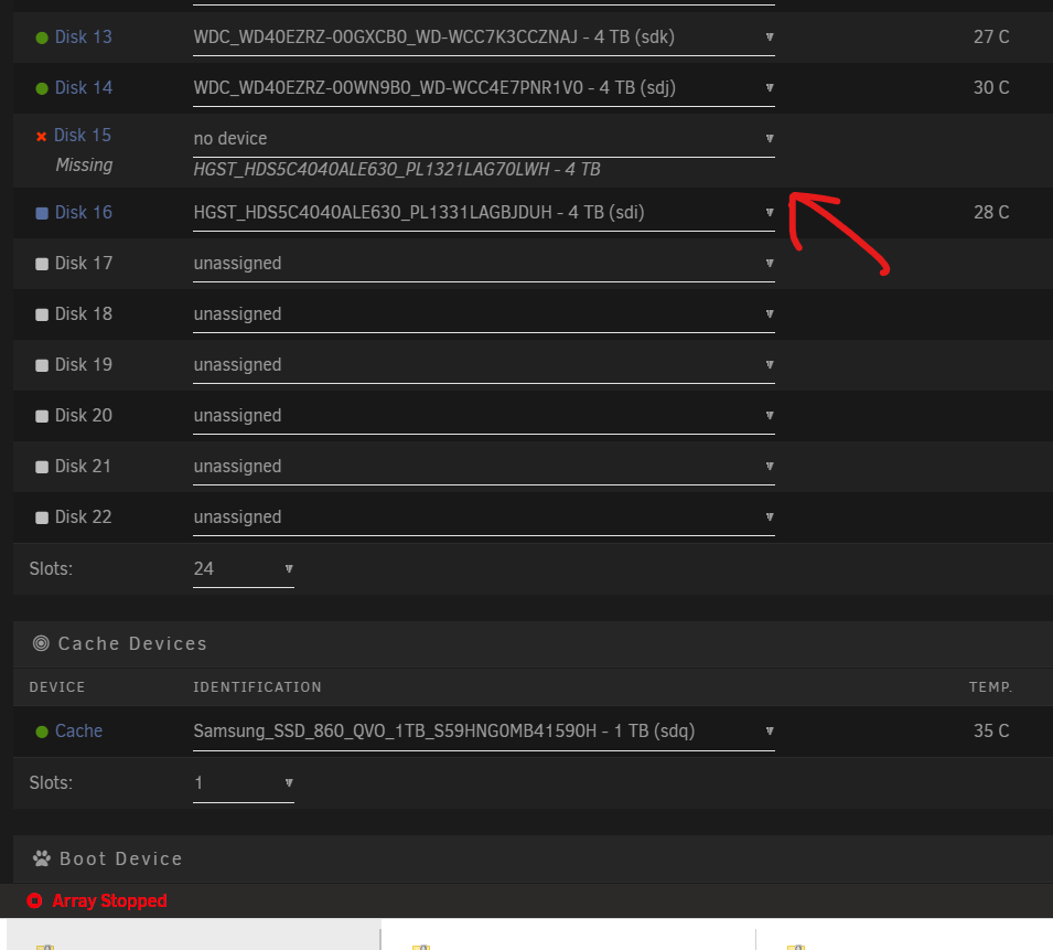

Ok I am just plugged in both drives again and I am at the drive mount screen I see both drives that were mounted in the 15 and 16 slots in the image can I send you a picture? If I try to change drive 16  or 15 to no device it says "too many wrong or missing disks"? The start button is also not active.
Its like I has to have both drives mounted or it wont start the array but it also won't mount the partition once it does start one of those drives.
I also tried the same on drive 16 and received the same error.
