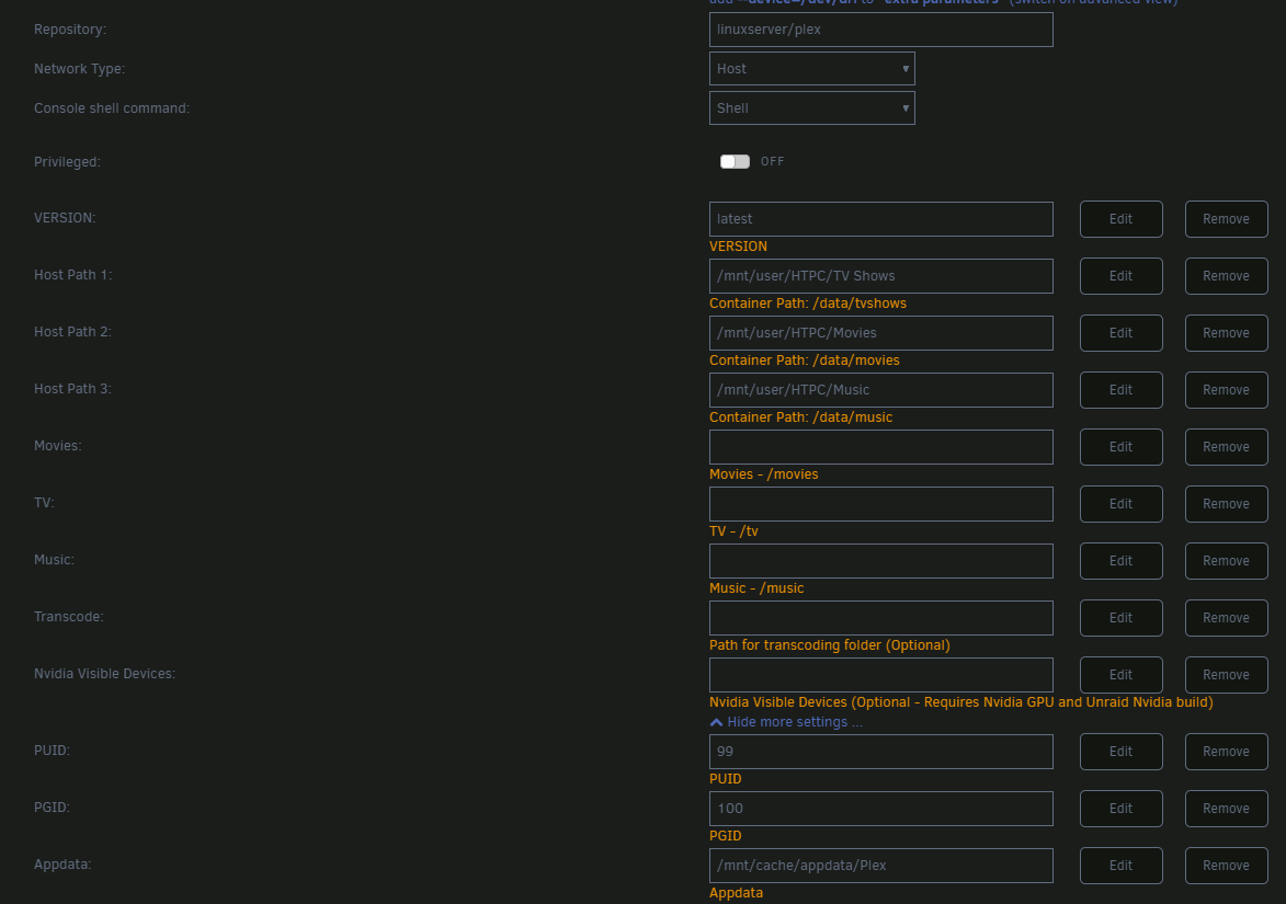

Plex docker configuration:
All of my dockers reside on the cache/appdata directory.

2 hours ago, jcreynoldsii said:
My docker is image size is set to 50GB, I am using about 23GB of that.  At one point in the past I ran out of docker image size so I increased it.
To me this suggests a problem with one or more path settings within one or more applications you have running as a docker container. I have 15 dockers installed and they are only using 44% of 20G, and they are stable at that amount of usage.
That plex screenshot isn't nearly as useful as the docker run command that results from it. See this very first link in the Docker FAQ for instructions on how to get that docker run command and post it:
What other dockers do you run?
I only use a few of those, and I'm not likely to do the research required to figure out how to use the others and what if anything might be misconfigured in them. Maybe someone else will contribute.
Plex is one I do use, and it doesn't write as much as for example some downloading application. Other than its library (appdata) the only things it is likely to write are DVR and transcodes. Do you use plex DVR? You don't have a mapping for transcodes. What does the application itself use for the transcode directory?
If you go to Settings - Docker and disable docker altogether, do you still get crashes?
No I don't use Plex DVR and I don't have anything mapped for trans-coding.  Should I make a directory on a share drive for it?  Or should I transcode to RAM?
