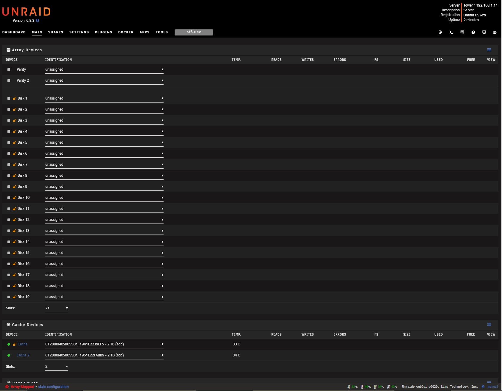

This morning I rebooted my server and Unraid didn't want to boot from some boot error (I do not remember or have a screen shot)
1) On a separate USB drive, I used a fresh install to see if Unraid would boot and it was not a hardware issue. It booted just fine.
2) I pulled down my latest USB backup and pushed everything to my active USB drive
3) Booting just fine now but I have a stale config (see attached image)
4) Everything in my `DRIVE_ASSIGNMENTS.txt` is correct. If I reassign everything correctly, it prompts me to choose a new passphase and my parities would be wiped. I'm using xfs-encrypted
Halp please 🙏
If you are sure the assignments are correct just enter the old passphrase twice, then check "parity is already valid" before starting the array.
I'll give it a shot and report back, thank you
Worked like a champ, thanks again 👍
