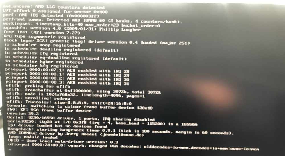

append initrd=/bzroot vfio-pci.ids=10de:1e89,10de:10f8,10de:1ad8,10de:1ad9
locks up Unraid while booting, see
Although the system hangs there, I could access it via the browser, but starting the vm wouldn't work with an error, that a usb did not work.
