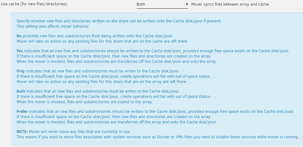

Add "Both" to "Use Cache"
I like to use only my SSD cache for some Shares, but by that I would need to create manually a backup routine. Instead I like to choose an option called "Both" where the Mover syncs between the Cache and the Share.
Example:
