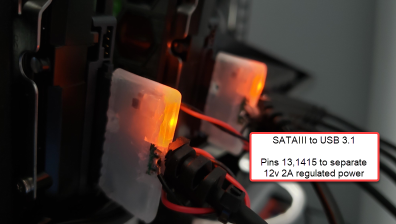

@Benson The drive that is having the problem is not the WD passport disk, it's a brand new internal Kingston 8TB 3.5" HDD. I have a USB 3.1 to SATA 3 cable for it
It's probable that the original NTFS partition is causing the problem (I initialized it on a windows machine with NTFS). I did not clean the disk after removing it from the Raspberry Pi4 and openmediavault.

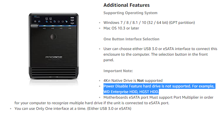

I think I have a solution for the SATA to USB hurdle. I found a 4 bay SATA enclose that lets me use a single eSATA cable.  https://www.amazon.com/Mediasonic-ProBox-HF2-SU3S2-SATA-Enclosure/dp/B003X26VV4/
You may got problem ( or just not work ) with those box with Unraid, eSATA ( SATA port multiplier ) will only work with limited SATA controller ( Intel SATA controller won't work ). For USB ( actually it is a USB to SATA bridge + SATA multiplier ) would be same.
Pls also note on product description, some HDD with "power disable feature" also won't support.
My previous build ( 2yrs ago ) was such kind setup ( USB 5 bays enclosure ), it need a suitable firmware to make it work. If you can't fix all problem then it just not work. Pls also note disk can't spindown too.
Some new design USB enclosure was a USB hub + multiple USB to SATA bridge, it may have higher compatibility, but it still not a good solution.

I think Kingston USB disk problem not hard to solve, it not work just because Unraid was partition aware, only single partition allow on data disk. If problem can't solve, just buy another USB to SATA bridge (single bay) can solve it easy.
