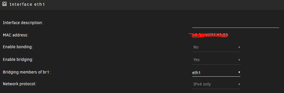

br1 is the designation given to a second NIC in the server with bridging enabled.
If you have a second NIC in the server and it is enabled in unRAID with bridging, it will show up in the custom networks list in docker containers as br1 (and br2, br3, etc. for subsequent NICs).

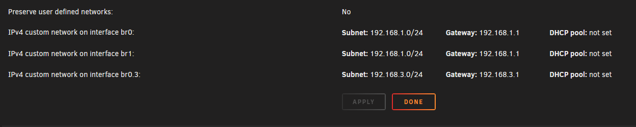

I do not currently have an IP address assigned to my second NIC, so it does not show up, but, here is my docker network list:
br0 is the bridged eth0 on which I get call traces.  br0.3 is the VLAN I created following this guide which eliminated call traces for me and allowed me to set static IP addresses for docker containers on this custom network.

I got around that by not assigning a DHCP pool to br0.3 in unRAID Docker networks and by assigning a DHCP range in my router that is a different range than the addresses on the 192.168.3.x subnet that I want to use for docker containers.  That way, I can assign a static IP address to each docker and I never have to worry about unRAID/docker or the router trying to assign that same address elsewhere.
In essence, each IP address is reserved for the docker container to which it is assigned.
