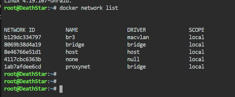

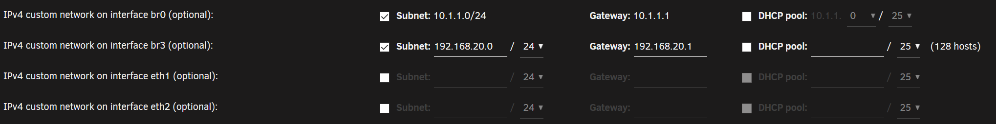

I was trying to add a separate network for the shinobi docker 192.168.x.x.(BR3) to another port on my 4 port nic and I screwed something up BR0 is gone and at one point i lost my main IP I renamed the network.cfg on the usb got my IP back but no BR0. Found a thread said to run:

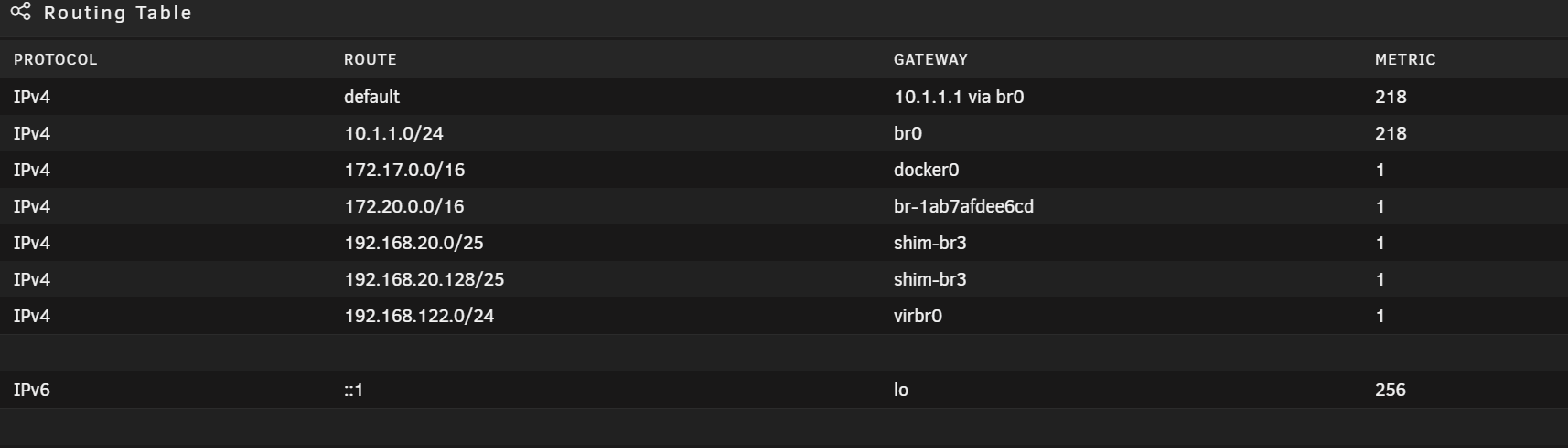

 rm /var/lib/docker/network/files/local-kv.db /etc/rc.d/rc.docker restart..  This worked got BR0 back for a day or two but now gone again? Also dose my route table look correct BR0 has a metric of 218?  Any help would be greatly appreciated. thanks

Just check that its enabled in settings docker advances view with the service stopped
yes its enabled
BR0 came back after I restarted my docker Image.  Guessing it will dissappear again? Thanks
Edited by Kodiak51103
So if I reboot my server BR0 is gone until I restart my docker image. Ideas?
