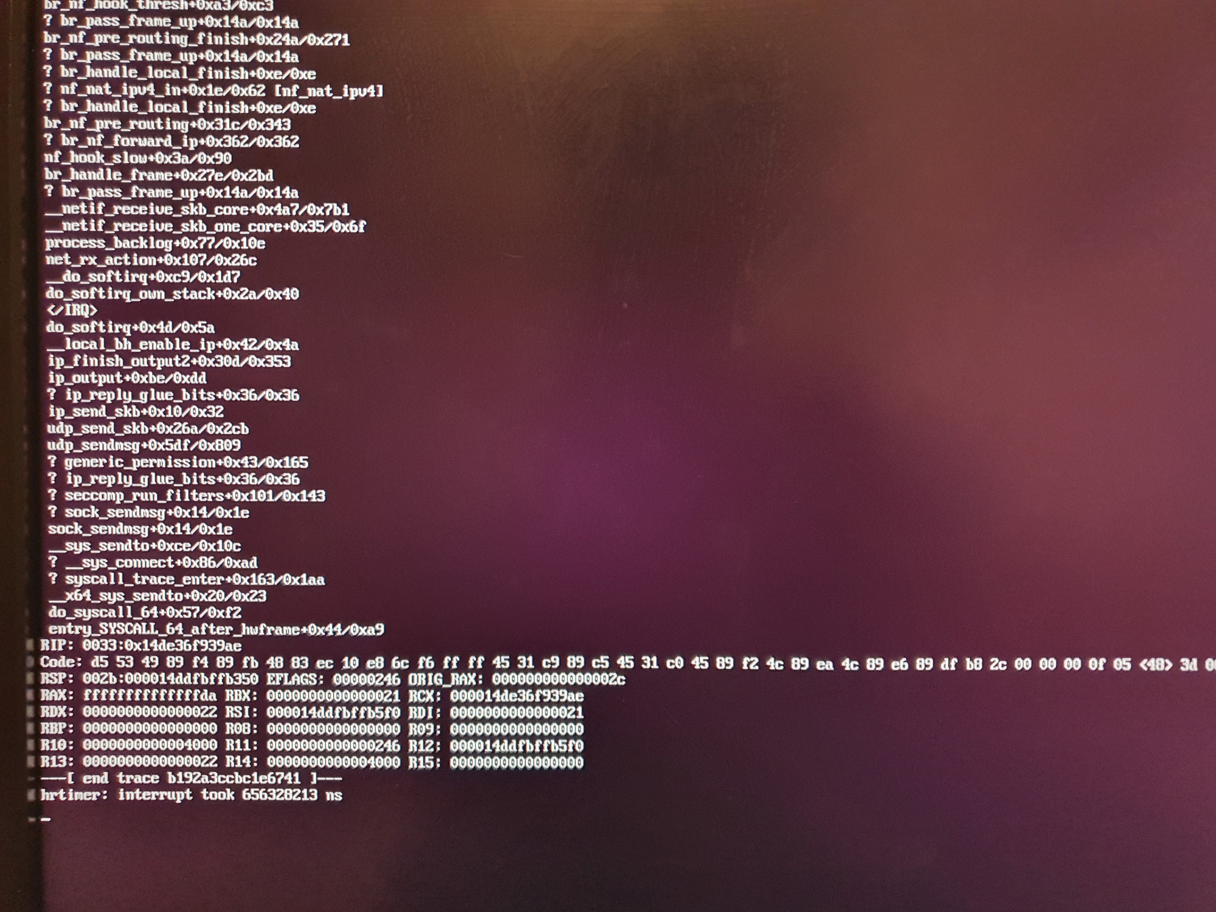

I'm currently experiencing a Panic / Crash on my 6.8.3 Setup
It's seems to be random, mainly happening overnight.
Happened again today, pulseway alerted me the machine was offline at approx. 5:55 (this can be delayed so not precise time)

Have you done memtest?
Memory Test Failed :(
4x4GB
I tried each stick separately and each of them failed, even tried in every possible slot...
I'm thinking it's more likely to be Motherboard or CPU.
Will mark this as solved as hardware issue, will re-open if continues once hardware has been resolved
