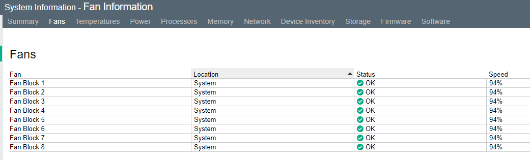

Both of them are running fine, however, the 2x10Core fans are running at 94% most of the time, even with the VM and dockers stopped.

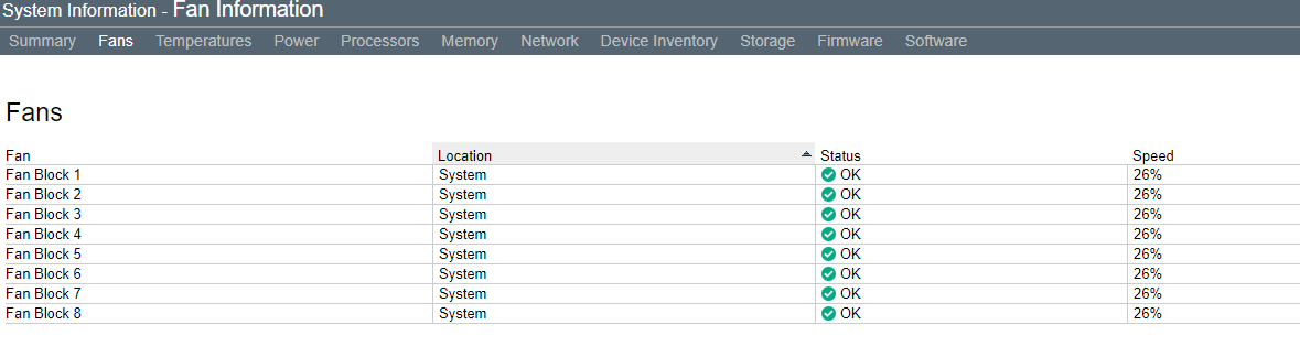

The 2x 6 Core is fine running at 26%
2x10Core:
2x 6Core
I cant really see any major difference between them.

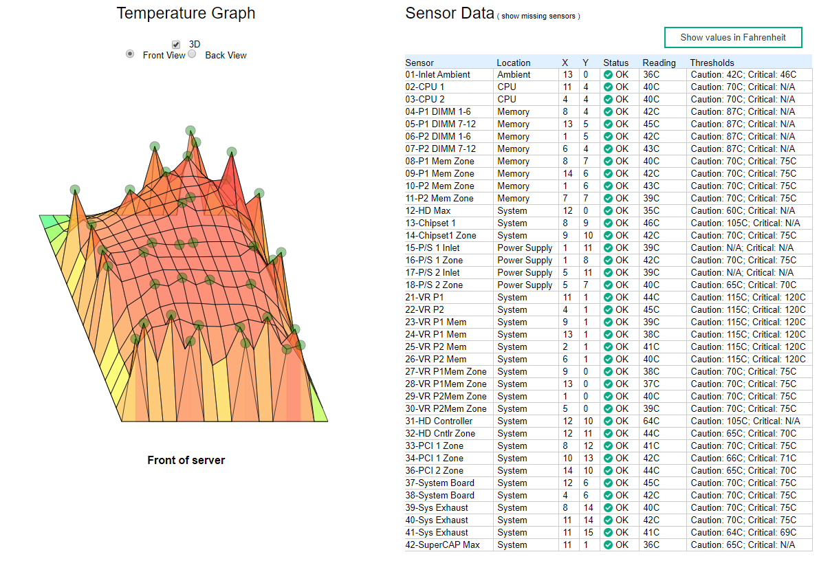

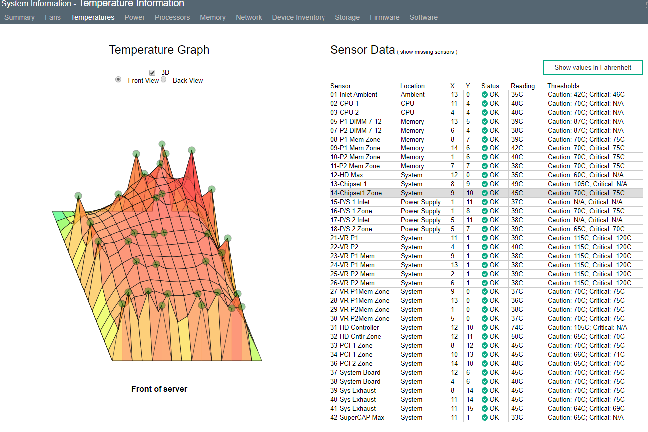

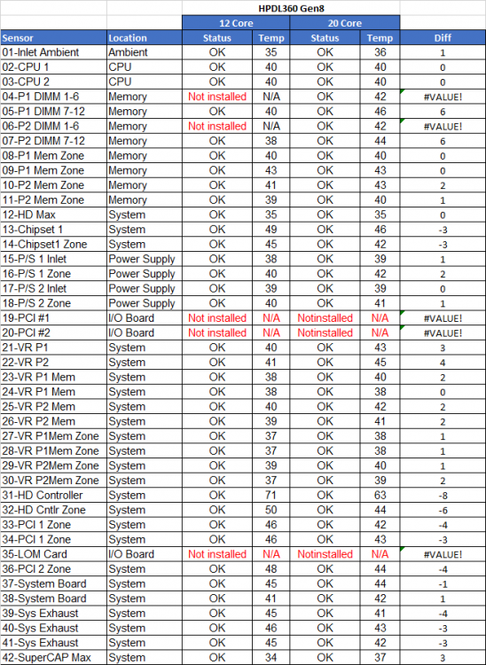

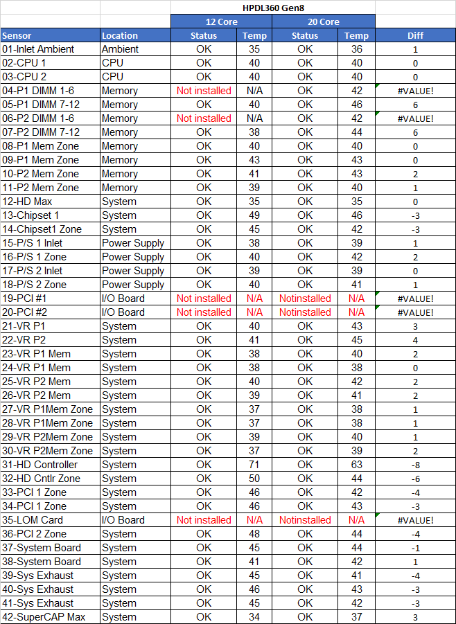

I copied the temps into a table to compare, not much difference, mostly the same on each sever, if anything the 20Cores seems to be cooler than the 12Core.
What brand are the HDD's? Are they HP SAS drives? My DL380p doesn't like non HP approved drives at all and spins up the fans If i install one. Also try removing the 3rd party card and seeing if that helps. They can be very stubborn servers!
also check your power settings in iLO.
Thanks, i checked they are all HP

Viewing the fans staus via iLo became tiresome,  I also had no way to view historical performace.  I decided to pull stats from the server (CPU, fan speed, temps, etc...) then plot them on a time series DB, that way I could compare temps v fan or CPU usage v fan.

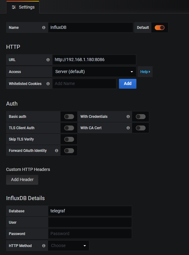

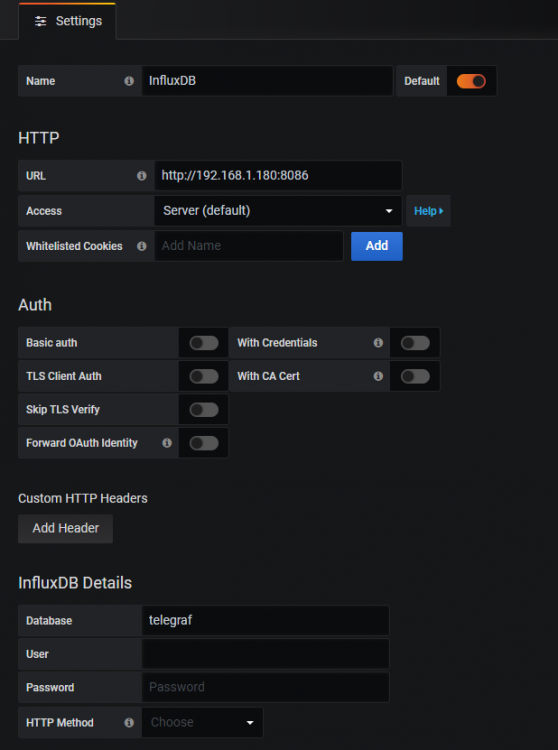

We need to connect grafana to influxdb, on the left select the settings icon and select data sources
Change the following:
URL: http://UNRAIDIP:8086
Database: telegraf
Hit save and test, if everything worked you should see the following:

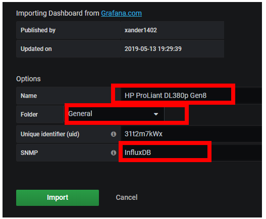

We could create a dashboard from scratch, but that will take too long, so lets import one.
Click the plus icon and select import:
Pre-made dashboards here, i tried both, neither worked straight away.
https://grafana.com/grafana/dashboards/10192 (DL380 Gen8 )
https://grafana.com/grafana/dashboards/10191 (DL360 Gen7)
Paste the id and hit the tab key, either 10191 or 10192

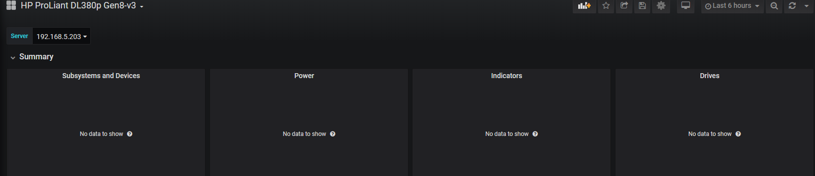

You should then see the following:
  • Name: whatever you want
  • Folder: general will make it easier to find in the future
  • uid: hit change if you see an error

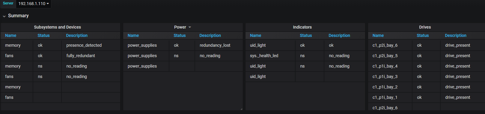

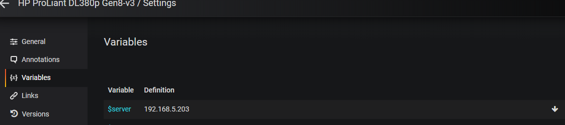

you should now see a screen like so, note the server address is wrong
Click the settings icon on the top right and select varibles
Double click on the server varible, change the values to match your server and hit the update button then go back to the dashboard.
You can now select your ip from the top left, select it and hit save
You should then see something like so:
Note the fans didn't work by default for me but mess around until you get it working as you like.

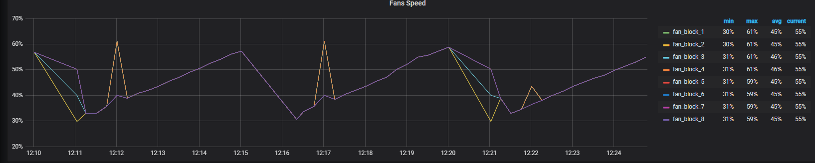

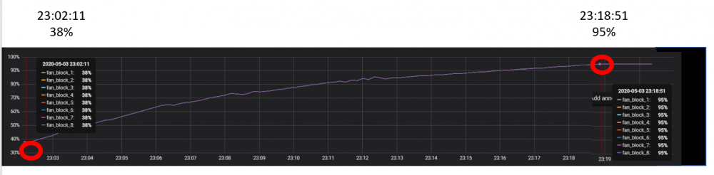

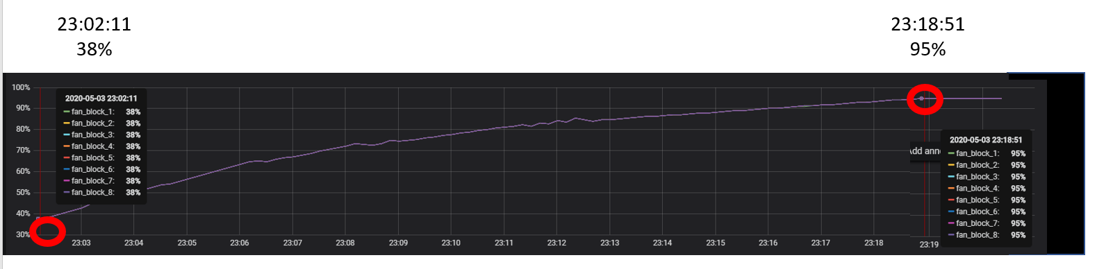

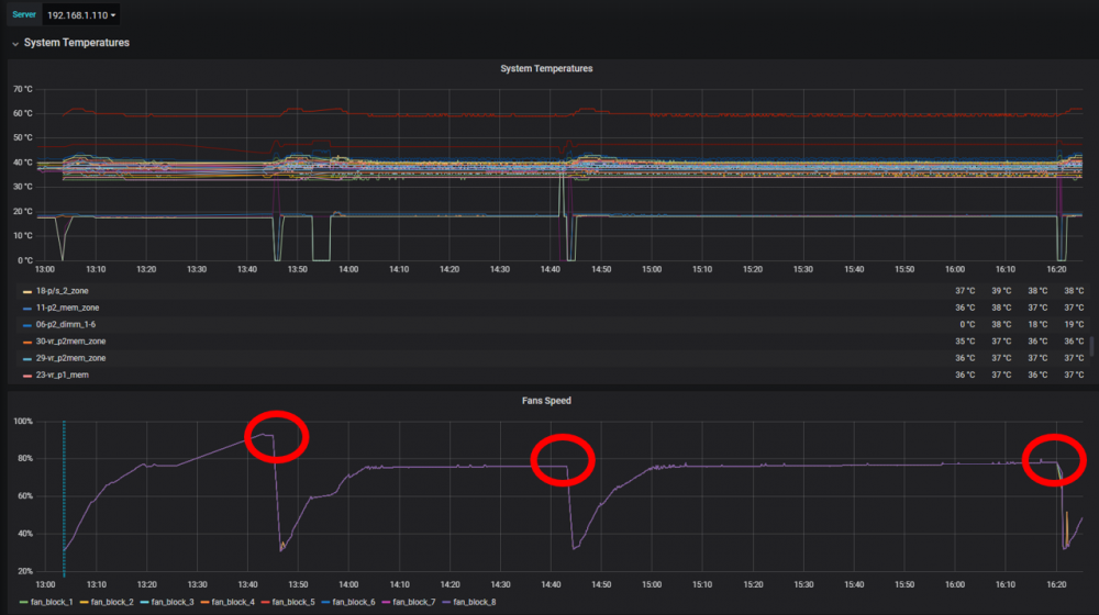

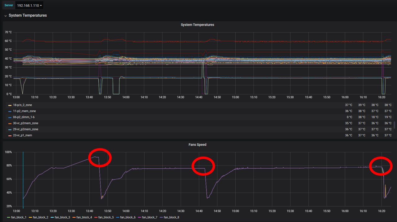

I can now see the temperature over time and the fan speed:
  • Notice the three red circles where the fans dopped down to 30ish %
  • I realized I had reset the ilo at those points, it had also reset the fans...
By running the following command, i could reset the ilo and thus reset the fans.
ipmitool -H 192.168.1.110 -U admin -P password -I lanplus mc reset warm
As the fans were still ramping up to 95% after 17mins or so -  I then decided to reset the ilo every 5mins...

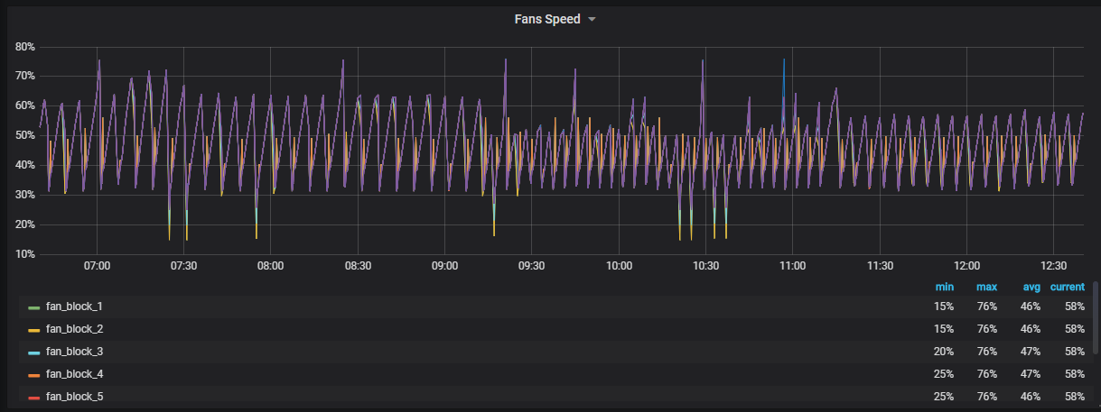

The average over a 5mins period is now 45% much better than 95%
While I clearly have not found the cause of the issue, I've least found a "workaround" for now... 45% average is much better than 95%.
Last 6 hours:
