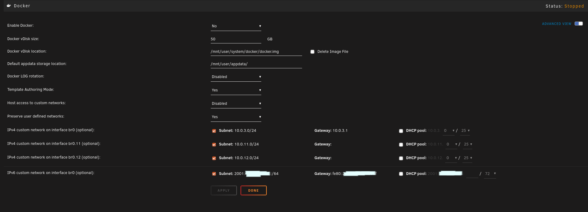

When there is no IPv6 network shown, it means docker did not create it (usually due to some configuration conflct).
Can you post a screenshot of your docker settings page, with the docker service stopped and in advanced view?
sure:
That looks alright. I need your diagnostics to do further examination. See Tools -> Diagnostics

A small update you may want to make, it is not causing real issues, but your network.cfg file includes eth1 and eth2, which do not exist (anymore).
Delete these lines
IFNAME[1]="eth1"
PROTOCOL[1]="ipv4+ipv6"
USE_DHCP[1]="yes"
USE_DHCP6[1]="yes"
IFNAME[2]="eth2"
PROTOCOL[2]="ipv4+ipv6"
USE_DHCP[2]="yes"
USE_DHCP6[2]="yes"
And change sysnics to
SYSNICS="1"
A reboot is required for the new settings.
Unraid gets a proper IPv6 address, but your router is advertising an additional /128 address, not sure why it is doing this. Check your router config.
This /128 address causes several issues, including Docker which doesn't accept a /128 subnet (invalid CIDR address) and this results in no IPv6 connectivity.

Then all my containers have the "--sysctl net.ipv6.conf.all.disable_ipv6=0 --sysctl net.ipv6.conf.eth0.use_tempaddr=2" extra parameters set.
This make Docker not bother at all with IPv6 assignments, does not do anything to the container routing tables, and does not add extra dns settings to the ipv4 settings. What happens then is that the network stack in the container will attempt to configure IPv6 via SLAAC and attempt to discover the router by router-advertisements over the wire, assigning a privacy address is desired. This mechanism works really well on my network running Mikrotik router (which does not have DHCPv6, so every thing is SLAAC using the dynamic /56 provided by my ISP. The whole thing works very well, particularly since the dynamic /56 has no gurantee of being the same across reboots, and with the absence of DHCPv6, my Unraid docker networks would not be configurable anyway. Also, I wanted to restrict which network interface and IP Unraid was able to use to host the SMB/SSH/HTTP services.
