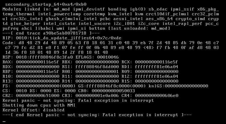

I have just received this from the console, anything useful here that may point to an issue?
Not really, try with a single DIMM/channel in use, if that doesn't help trying a different board would be my next move.
