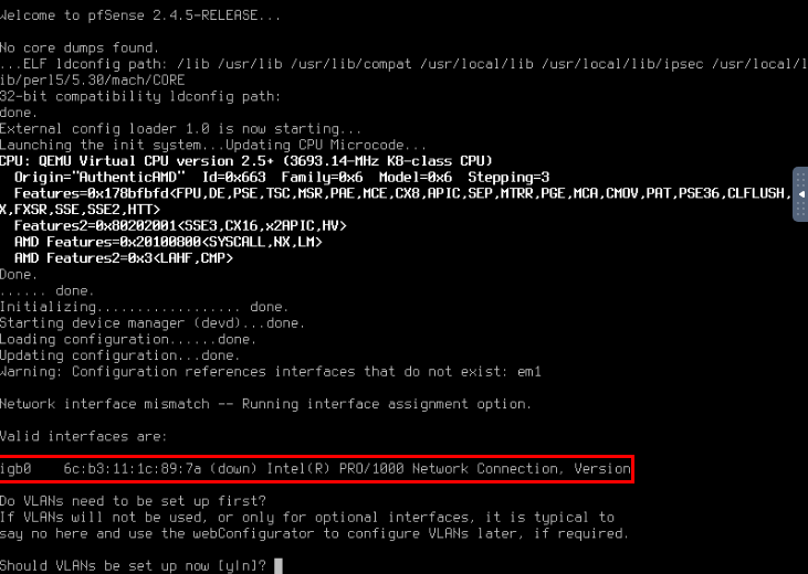

The issue is that while pfSense detects the NIC it only has one interface available for configuration on startup:
https://imgur.com/6pH5xbw

@DaveDoesStuff Did you tried to also bind the "[1022:43c7] 02:04.0 PCI bridge" to vfio and pass it to the VM? Binding might be already enough. Usually you have to passthrough all members of an IOMMU group to make it to work.
I'm not sure (if I did it wasn't on purpose) as I got the NICs in the VM XML originally by selecting their checkboxes on the VM edit page (not XML view). Only the two nics were there, no controller.
I'll give it a try (add to flash default etc) and see if I can pass it through. Thanks.
On second thoughts I don't think I can exclude the controller, it's in use across several iommu groups as you can see below:

But upon booting up pfSense it unfortunately still only detects one interface:
1017042142_2020-05-0113_28_21-QEMU(pfSense)-noVNC.png.87e45ee7808369ba53fec4e5ee68baee.png
Are both nics still configured as multifunction in the XML? Please post your XML.
Eh, I added in the multifunction bit to the xml the way I saw it done in another guide (to the top device, not the second) as in the below. But maybe that's not correct:
Exactly way to go, usually. If you define them as multifunction, they have to be on the same bus. 05:00.01 isn't on the same bus as 05:00.0. Either try to put it also on bus 1 (bus='0x01') with function 1 (function='0x1')
      <driver name='vfio'/>
      <source>
        <address domain='0x0000' bus='0x05' slot='0x00' function='0x0'/>
      </source>
      <alias name='hostdev0'/>
      <address type='pci' domain='0x0000' bus='0x01' slot='0x00' function='0x0' multifunction='on'/>
    </hostdev>
      <source>
        <address domain='0x0000' bus='0x05' slot='0x00' function='0x1'/>
      </source>
      <alias name='hostdev1'/>
      <address type='pci' domain='0x0000' bus='0x01' slot='0x00' function='0x1'/>
    </hostdev>
Or remove the multifunction completly and put both devices on different buses
      <source>
      </source>
      <address type='pci' domain='0x0000' bus='0x01' slot='0x00' function='0x0'/>
    </hostdev>
      <source>
      </source>
      <address type='pci' domain='0x0000' bus='0x03' slot='0x00' function='0x0'/>
    </hostdev>
EDIT
I should've noticed this on your initial xml posted that the addressing of the bus is wrong. Device configured as multifunctional but not on the same bus. 😒
      <source>
      </source>
    </hostdev>
      <source>
      </source>
    </hostdev>
      <source>
      </source>
    </hostdev>
      <source>
      </source>
    </hostdev>
EDIT
IT WORKS!
Yeah it all makes sense to me now, but I'm not used to working on passthrough like this. Used to the GUI from ESXi :D...that and I kinda trusted unRaid to just pick the right options after the devices were assigned to the VM. Lesson learned!
I'll leave it as is for now but possible switch back to the flash conf method later incase I forget what I did and it's suddenly "not working" again after a device change lol.
Thanks for the assist!
1 hour ago, DaveDoesStuff said:
IT WORKS!
The multifunction option is kinda a workaround in certain cases, like some AMD GPUs need it. In most cases it isn't needed and most setups work without. If you kinda understand the basics and know how to fix small things, Unraid is pretty easy to get to work, but every setup is different and kinda every user has it's own small quirks.

Hello everyone,
I'd just like to add that I had tried everything in this thread and I was still only seeing 1 interface (2 available on my i350-t2 Intel pro 1000 NIC).
I was able to fix it by switching my machine type from Q35-4.2 to Q35-2.11.
