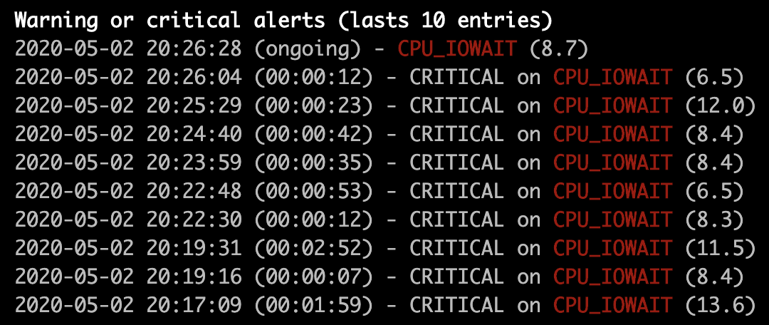

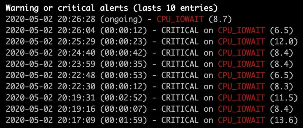

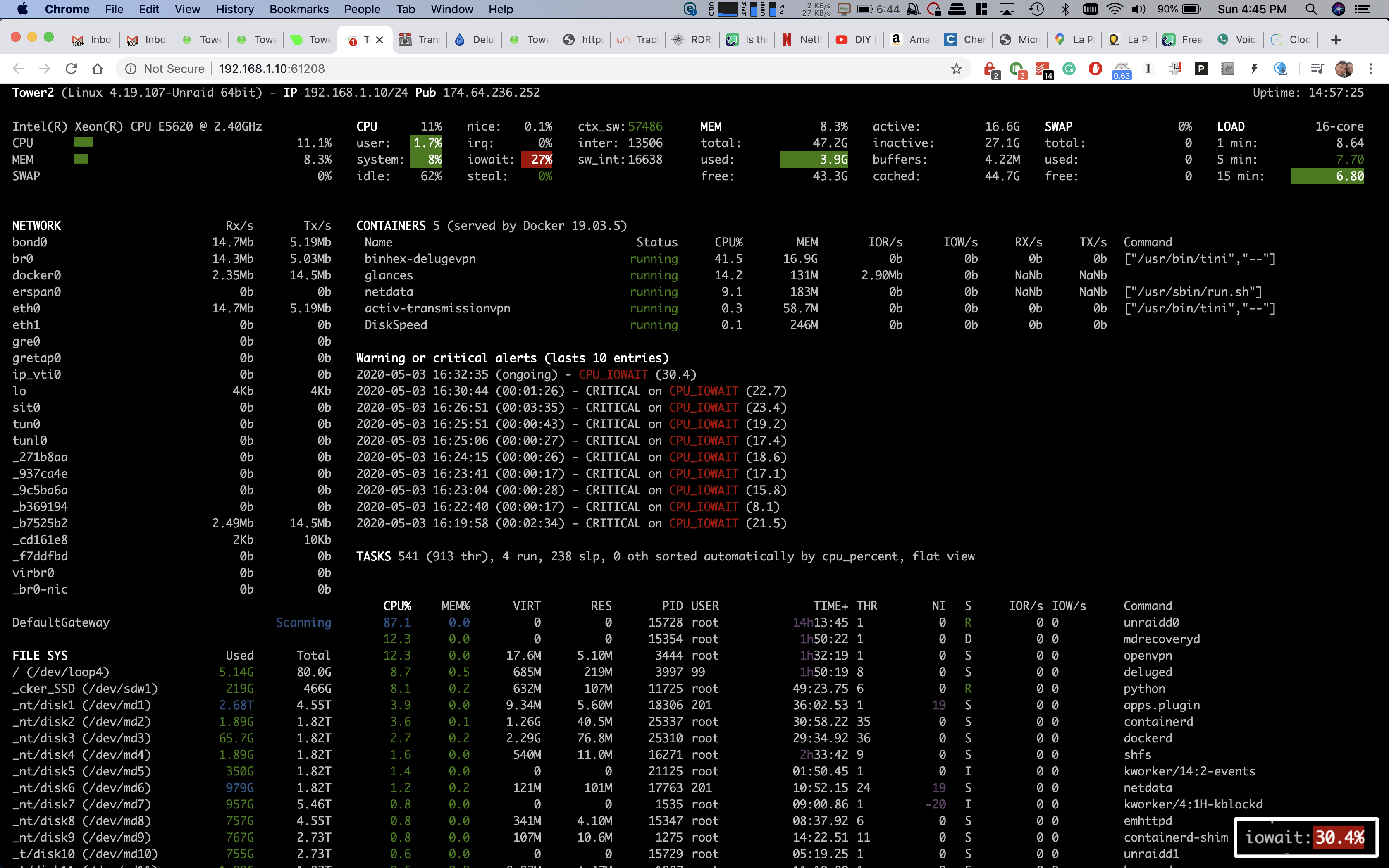

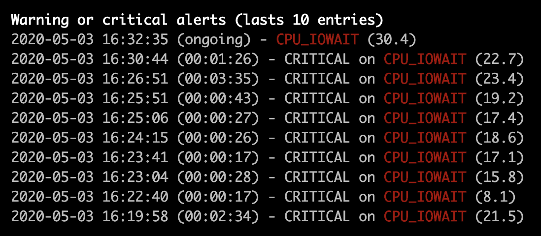

Most of the dockers have not been slow, only plex, smb and webgui. Parity checks and the like have been at 90-160mb/s.
561952334_ScreenShot2020-05-03at4_45_48PM.png.4e8a3f5724dfd1858f90b88f0fbf9955.png1461636339_ScreenShot2020-05-03at4_45_49PM.thumb.png.178b4324bf2e3ef0acad9d36091e2845.png564829570_ScreenShot2020-05-03at4_45_53PM.thumb.png.8dc84ca036c4085e3d24bd03ee5859b9.png

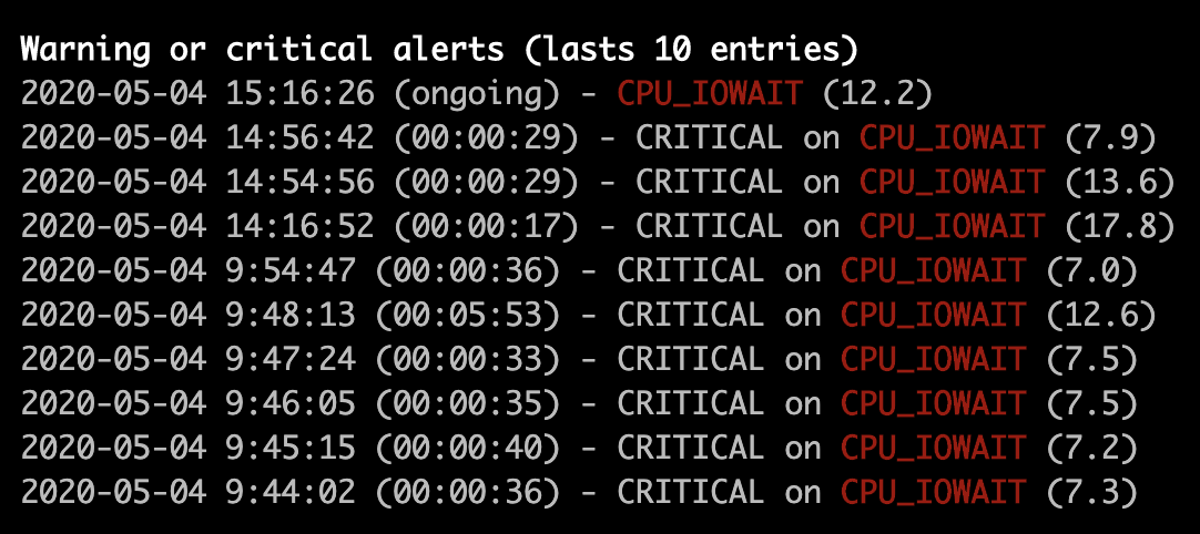

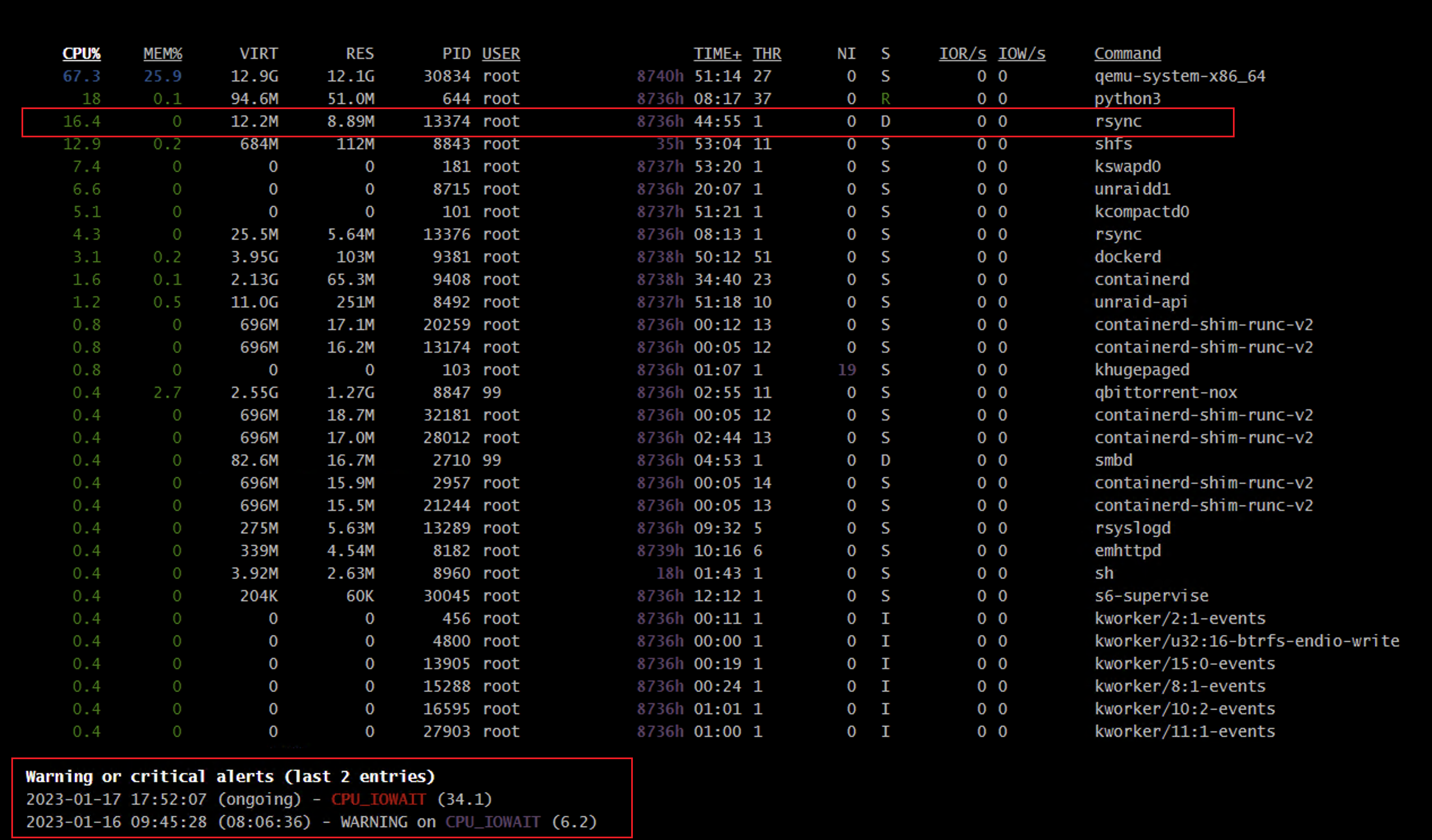

Same problem here. My system is strong enough, however I get IOWAIT up in the 50-60% ranges.
I have been dealing with this as well for a couple weeks. I can't seem to figure out what the exact cause is. when I check the logs is seems one or the other of my ssd cache drives resets failed scmd and I also get io errrors sector xxxx op 0x0: (read)  flags 0x80700phys_seg 1 or 2 or 3 or 4 prio class 0

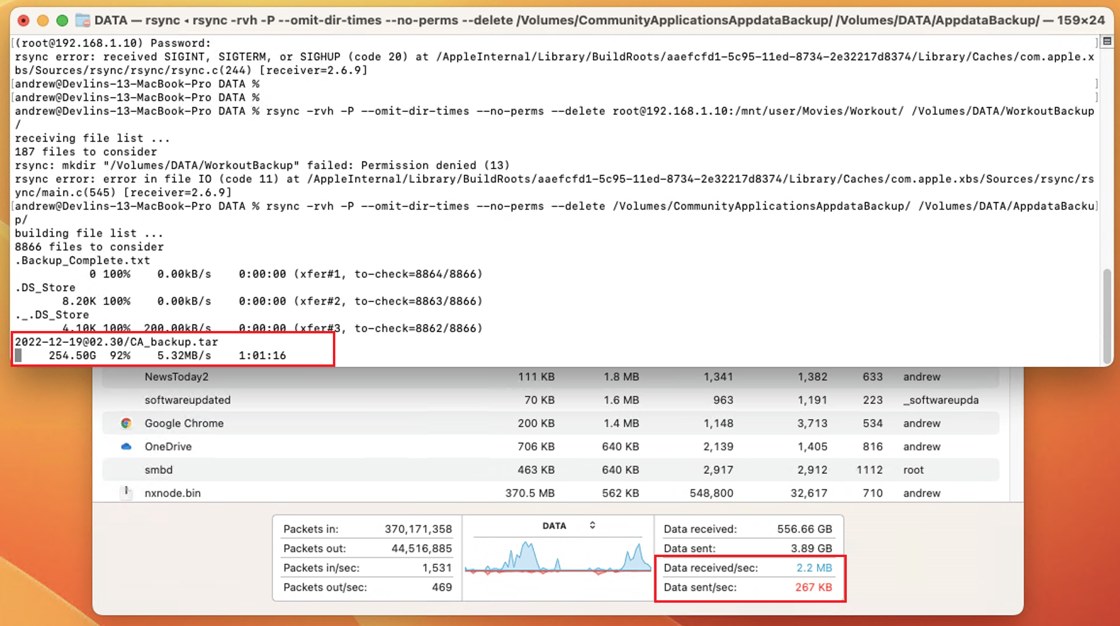

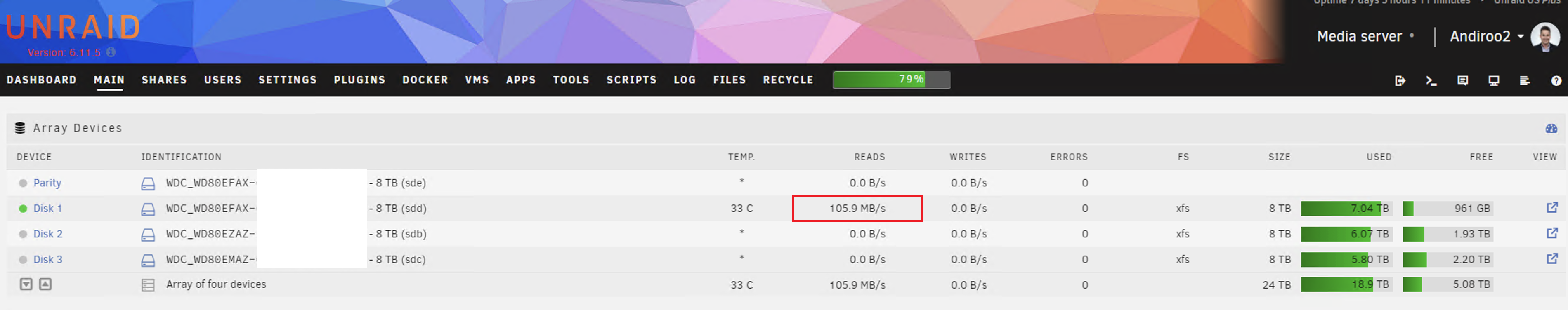

I'm having this issue when trying to export data from the array to another server for backup.  Speeds start around 30MB/s and drop to around 5-7MB/s.  IOWAIT sitting around 33.3 according to glances.  No other activity on the server at the same time.
What's interesting is that the array shows ~100MB/s of reads, but there is only a trickle going over the wire.
It's like the system is spinning it's wheels trying to get the data ready to send, but can only send really slowly. For reference, I am "pulling" data from Unraid to macOS.  I am running the rsync commands on MacOS, connected to Unraid via the network.  I have been trying with rsync over SSH and just via SMB but no real difference.

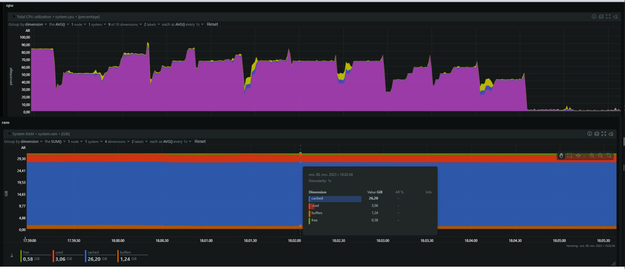

Working Hypothesis:
Monitoring with NetData.  Noticing IOWait jumps typically correlate with Memory Writeback. Specifically Dirty Memory Writeback. All my research comes back to either bad/lacking ram (which I will be swapping all of them out to 384GB) or Tunables need further adjustment.
Edited by maust
