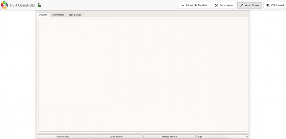

May 19, 20206 yr Hi, Thank you for this plugin! I've been looking for something like this for a while. I however don't fully understand the setup. According to the information provided with the app there should be a "detect devices" options somewhere. I cannot it anywhere? Attached a screenshot of my current GUI.

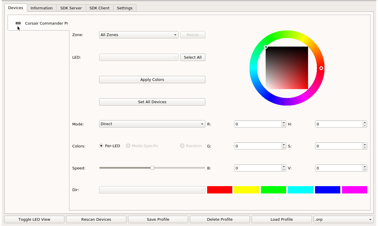

January 7, 20215 yr It finds my Corsair Commander Pro, but for the life of me, don't know how to use this application. Anyone successful in using this app?

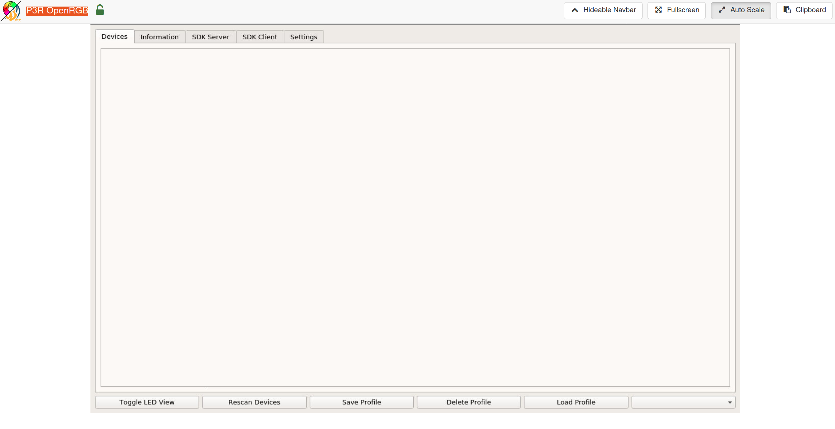

March 22, 20215 yr i have the same problem ! MSI X570 Godlike under "settings" all was set to "true" but under "devices" i will see nothing Please Help... Edited March 22, 20215 yr by SpiderPOH

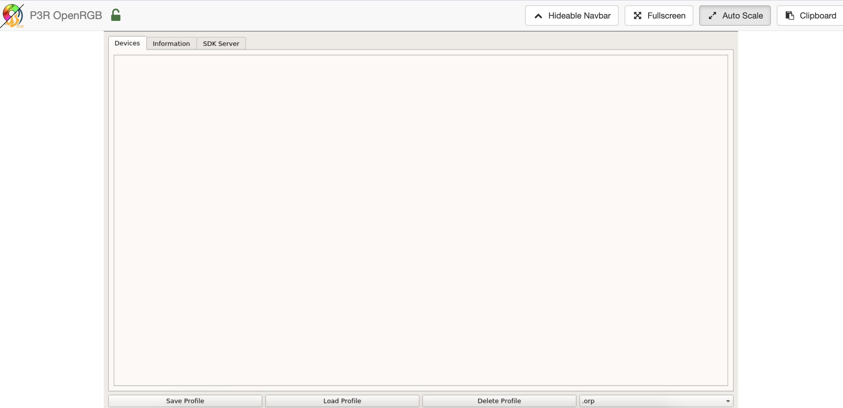

May 6, 20215 yr Hello, Same issue, i have an Asus X570 motherboard. Works fine with the OpenRGB docker. but my HyperX RGB Ram isn't detected. I tried the "modprobe i2c-piix4" and "inserted acpi_enforce_resources=lax" to the kernel command line, but it doesn't change anything. Apparently the PIIX4 driver needs to be patched in unraid, when it comes to patching kernel, I don’t feel very confident. if anyone has a guide
January 15, 20233 yr #meetoo 😁 Tried this openrgb docker with my ASUSTeK COMPUTER INC. TUF GAMING X570-PLUS (WI-FI) Mobo, "no devices" are found 😞 Tried to add Ich777's patch, still "no devices" are found 🤧 BUT! if I setup a VM running windows and install OpenRGB there, it finds (if I allow QEMU to pass on the Aura USB device to the VM) the Aura device and uses it fully! So why can a virtual machine access a hardware device that a docker has no access to??? (I like to run the docker because I find it a bit too much to run a complete VM just for some LEDs)

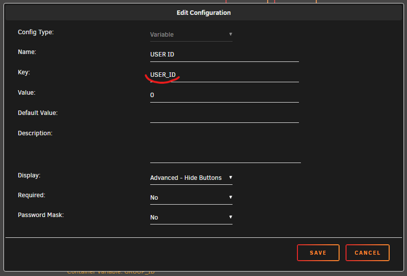

March 30, 20233 yr Ran through this recently, saw a post (can't remember which) that mentioned that the container had some configs wrong for USER ID and GROUP ID (both have a 0 as the key value, which is incorrect) Once I modified them (Go to advanced mode, when editting the container settings) to their proper values (GROUP_ID and USER_ID, respectively) the container identified my devices correctly: Also added the different i2c's found using modprobe, like so: Edited March 30, 20233 yr by jemtz
