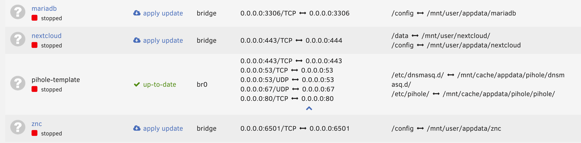

I had trial and error in terms of what dirs I could copy over from my old /config dir on the corrupt USB flash drive. Initially I copied over the whole /config folder but nginx and php wouldn't start automatically, and when I did, I had a lot of the same web UI errors I had in my first post.
Thus I created a fresh USB with only the shares folder and smb-extra.conf file which worked. Unfortunately now I have a bit of configuring to get my docker containers and Unraid settings back to how they were.
I'm currently in the middle of reconfiguring my containers by redownloading them from Community Apps and mapping paths, IP:ports again as this is the current state of my containers:
Documenting this here in case anyone else comes across the same issue.
