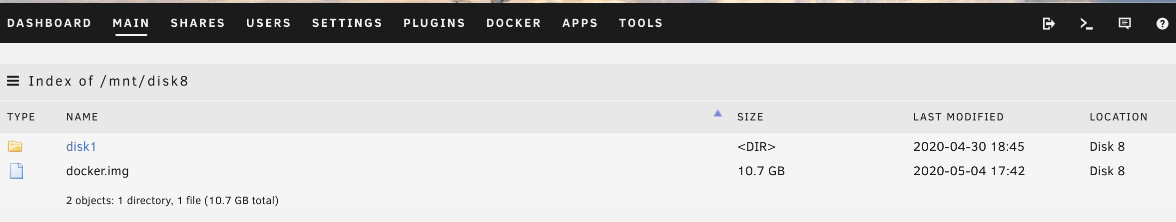

Here's what my XFS swapper disk8 looks like with all the data from disk1 in the /disk1 sub-directory

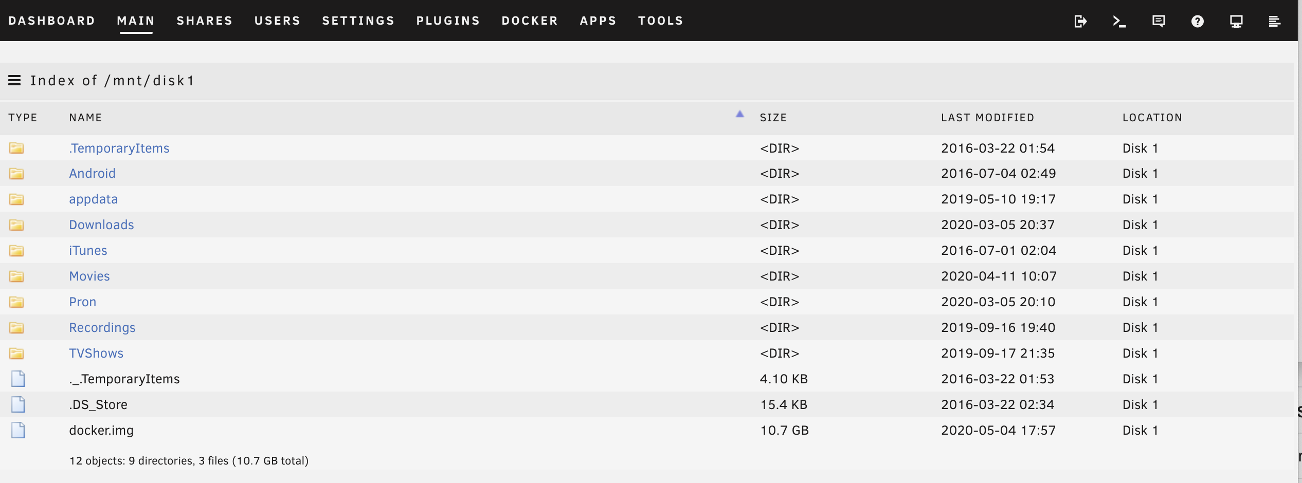

Here's what my actual ReiserFS disk1 contents look like...
Now that I wrote this is it because I didn't put the trailing "/" for each directory in the rsync command..
Should've done "rsync -avPX /mnt/disk1/ /mnt/disk8/" instead of "rsync -avPX /mnt/disk1 /mnt/disk8"
Is the best thing to do, is erase everything on /mnt/disk10 and start the rsync all over again(took about 2 days) or take another path?
Easiest thing to do is move the content of the new Disk1 folder to the root of the disk. You can do that using mc at the command line, it should only take seconds.
