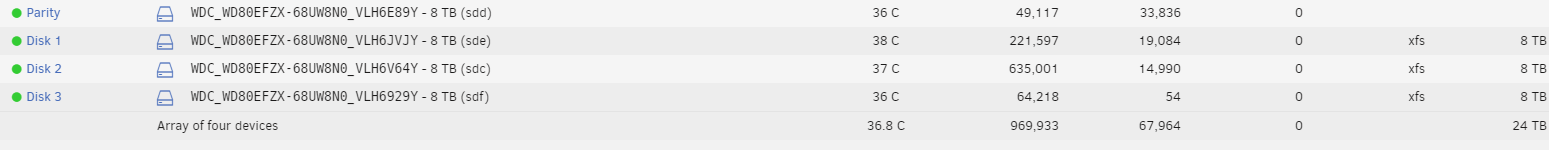

I'm also wondering how I can find out why this drive in particular is being used so much more than any of the others. (4x 8TB WD RED installed same date)
See attachment (Disk two is the dying one)
