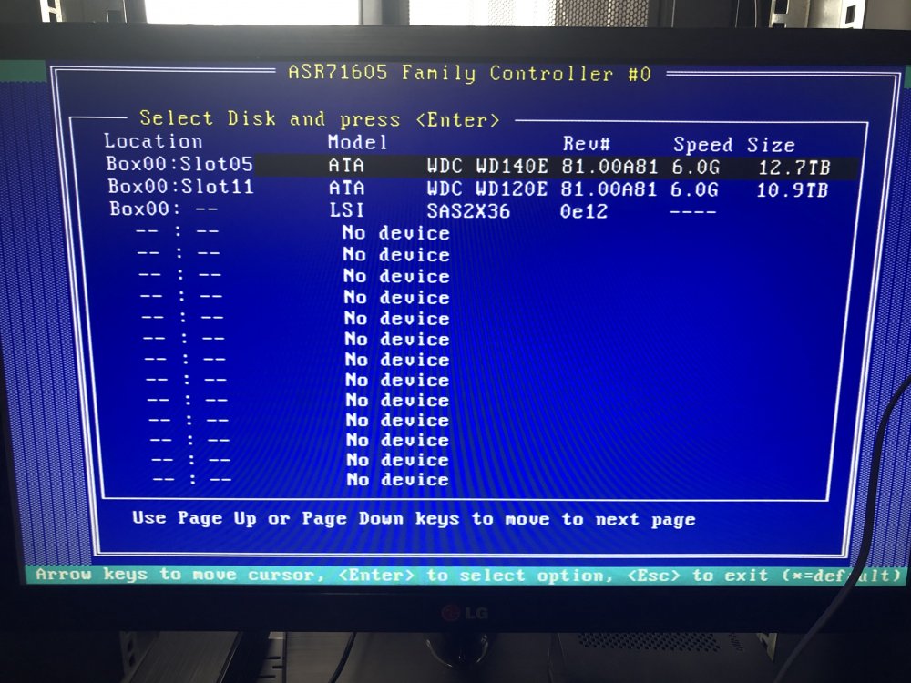

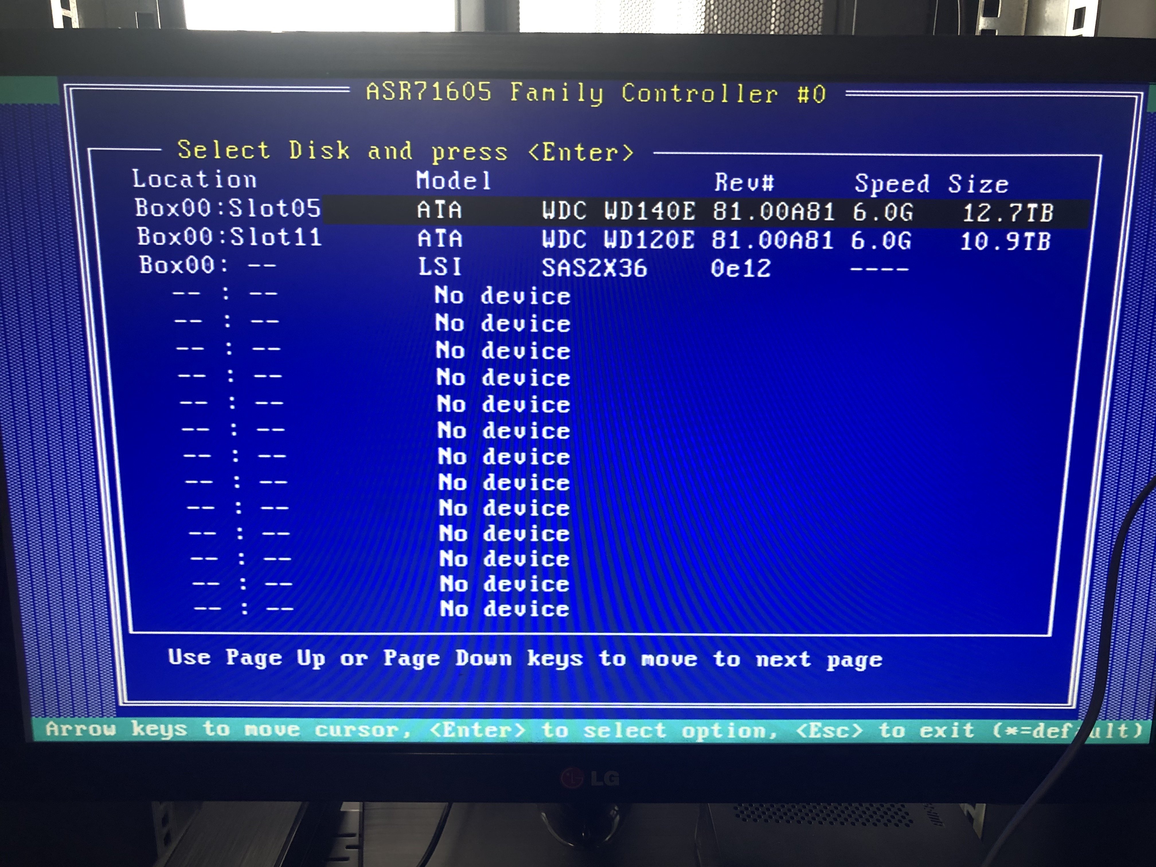

The system is a SuperMicro CSE-846 with a X9DRi-F motherboard. It has an Adaptec 71605 1GB (SAS/SATA) RAID card installed connected to a backplane. I have configured this to HBA mode.
I have installed a 14TB WD drive and a 12TB WD drive into the server. Both drives are recognised within the raid controller config screen. See screenshot.

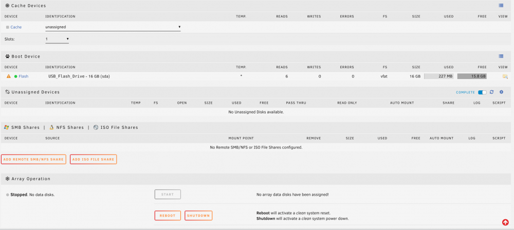

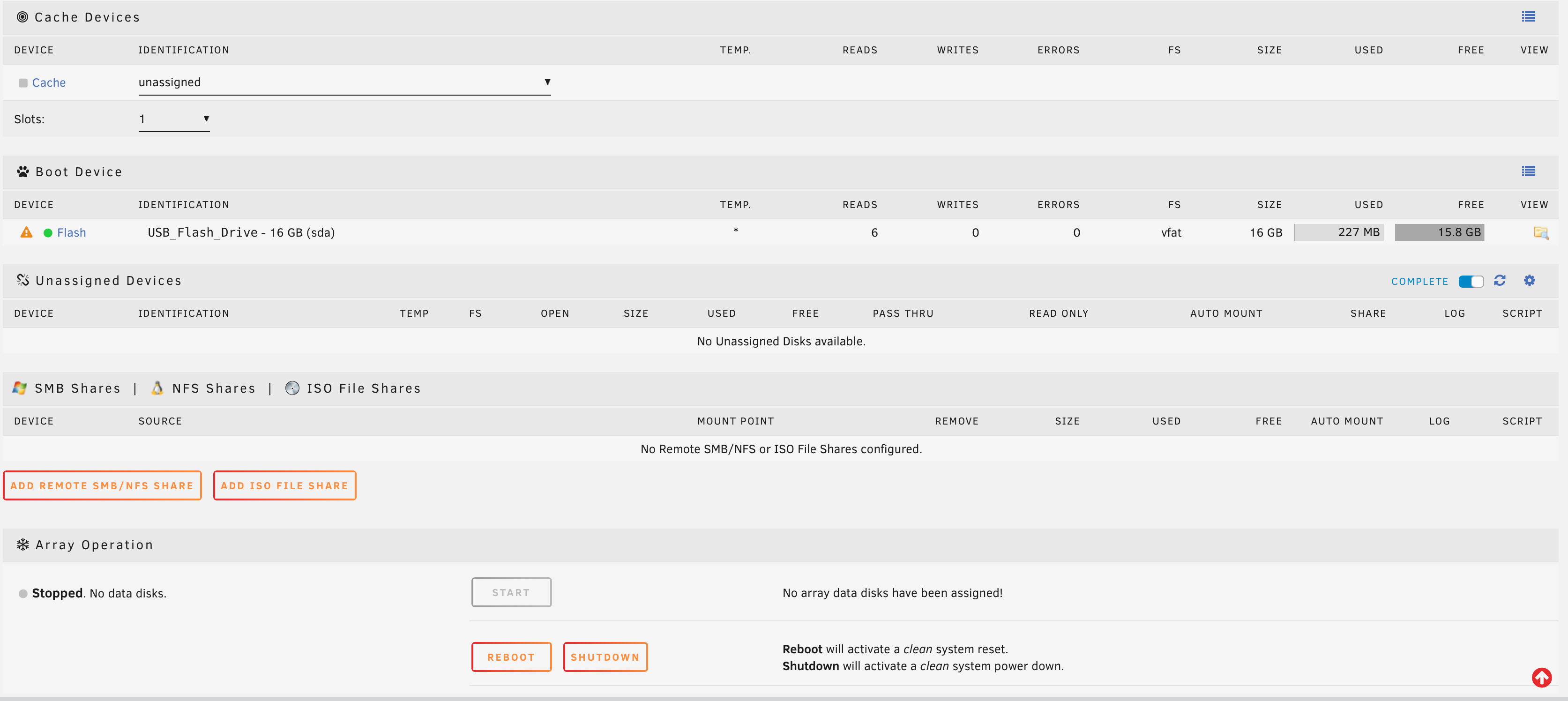

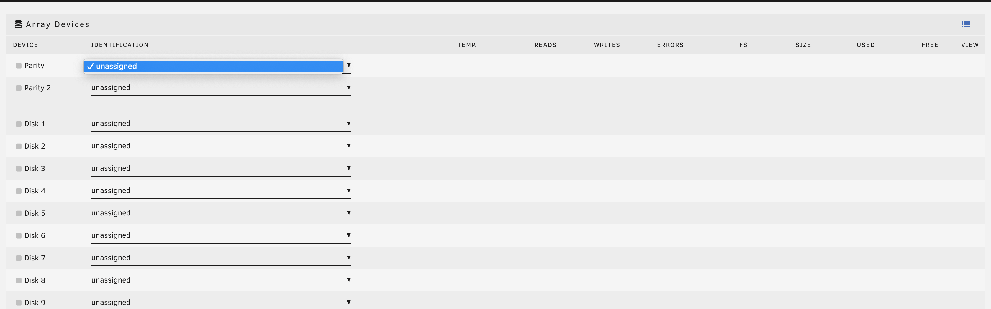

When booted into Unraid I cannot see the drives and on the one occasion this evening I managed to see a drive, it could not be selected in the dropdown to create an array. I downloaded the plugin unassigned devices and drives did not show here. I have plugged the drives into a Windows PC and it was instantly recognised by Windows. I used Windows to do a quick reformat of the drives but they still did not show in Unraid. Shutting down and starting up the system I eventually got Unraid to show the 14TB drive as a SCSI device but still could not mount it, assign it as parity or data drive. I restarted the system in the hope of also having the 12TB drive appear but in doing so lost both drives from view of Unraid and haven't been able to get them back.

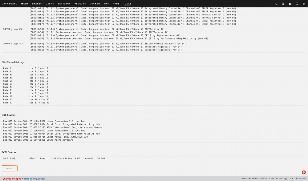

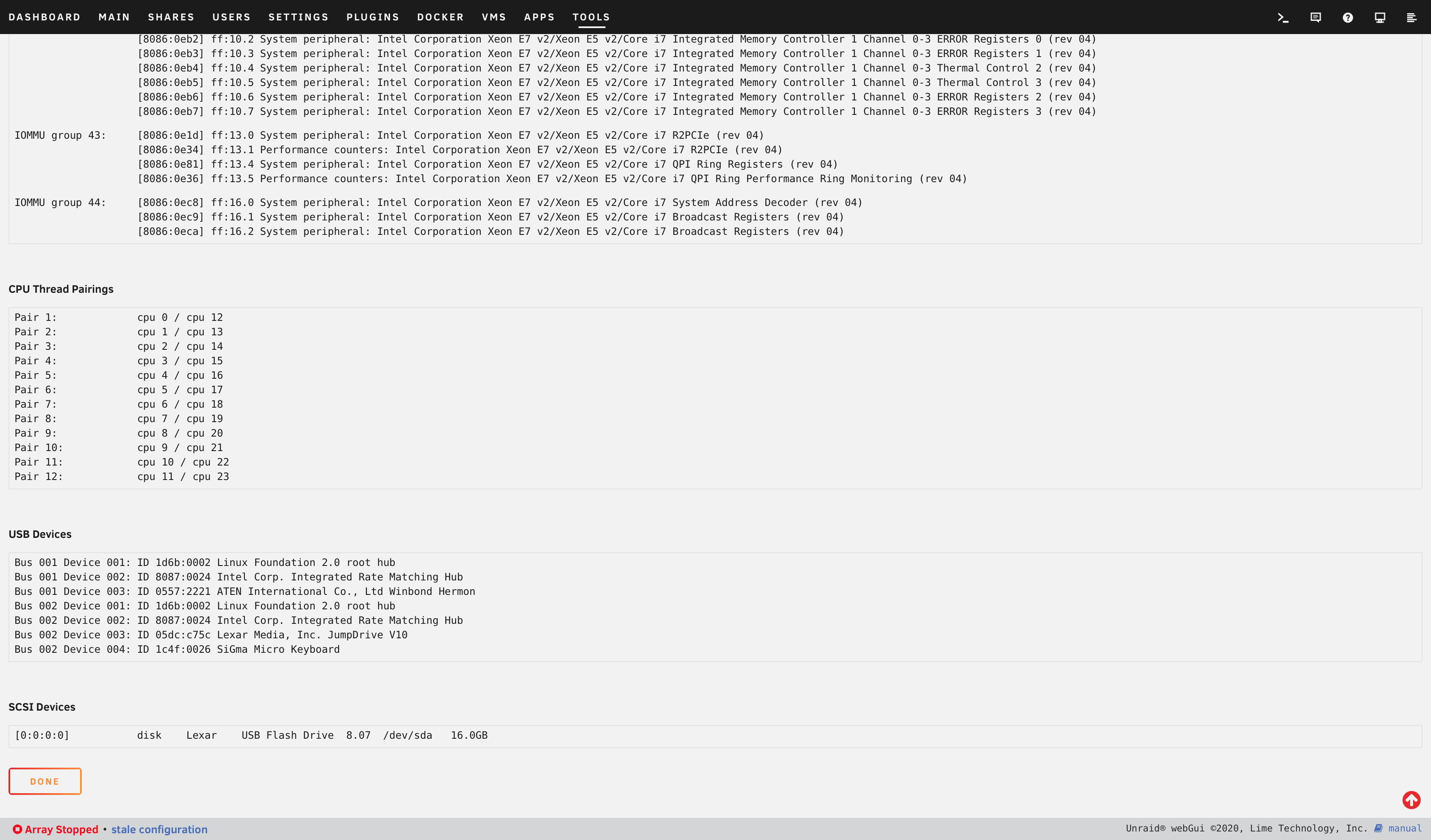

I don't know what help it is but, before I shut down and left the server for the night I took a copy of the system log. At this point it did not recognise the drives in Unraid. Text file attached. I have also attached screenshots showing drives not there.
This is likely the problem, RAID controllers are not recommended for Unraid, but please post the diagnostics: Tools -> Diagnostics
