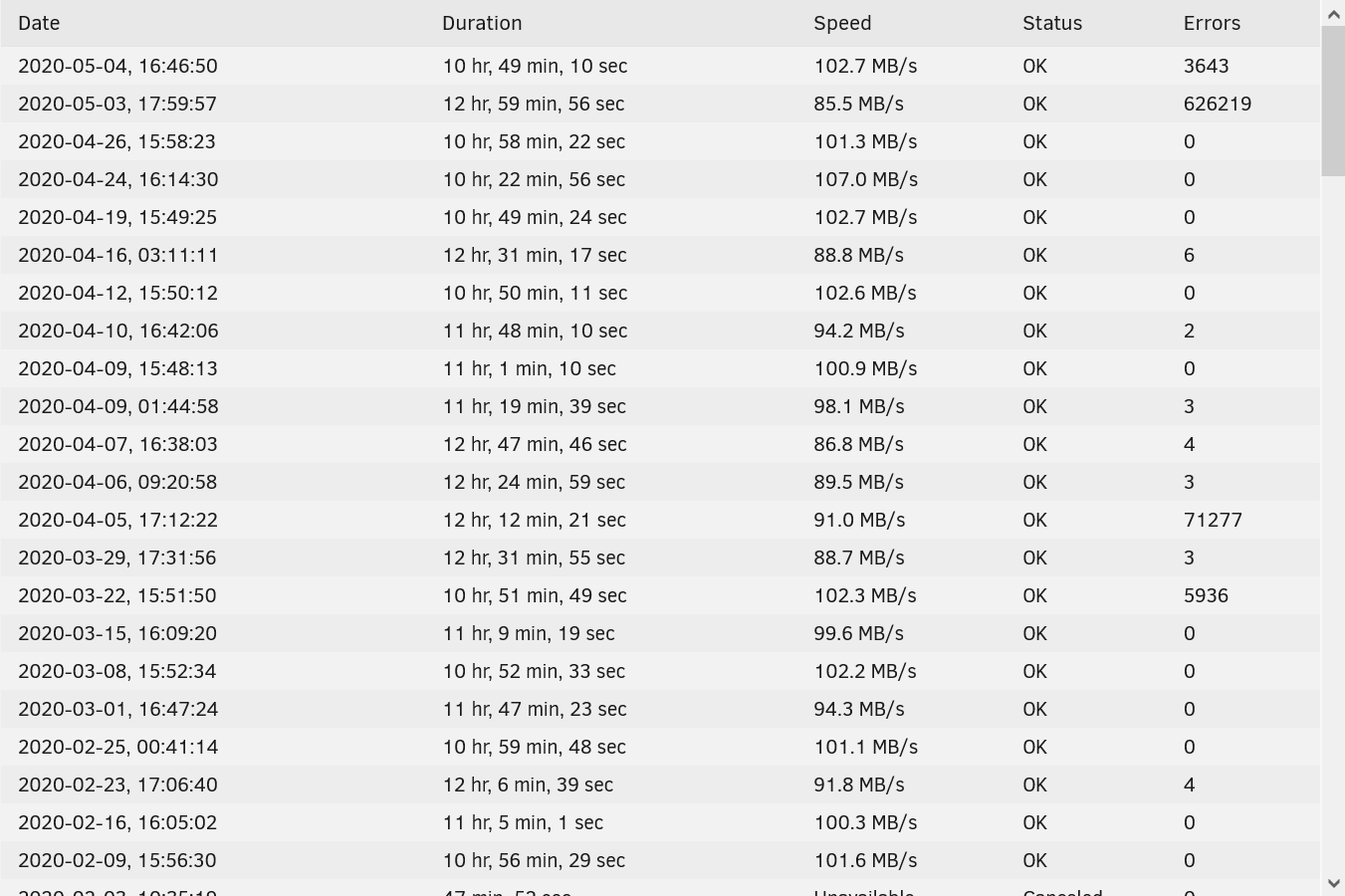

Hello everyone.
My unRaid sever has started to report parity errors. The first errors came on 2020-02-02 (1514 errors), then no errors until 2020-02-23 (4 errors). Since 2020-03-22 I have been getting errors frequently as seen in the screenshots. There might have been an unclean shutdown before 2020-03-22, but since then I have restarted the server a few times and not had unclean shutdowns. I got 626.219 errors on 2020-05-03, quite a lot I think, ran the check again and got 3.643 errors (2020-05-04).
I have attached the diagnostics. Thanks in advance.
tower-diagnostics-20200505-2319.zip

And it's missing most of the first check, not showing any corrections, it does show a lot of errors on ATA2 (disk1) so also replace cables on that disk and do the 2 consecutive checks.
