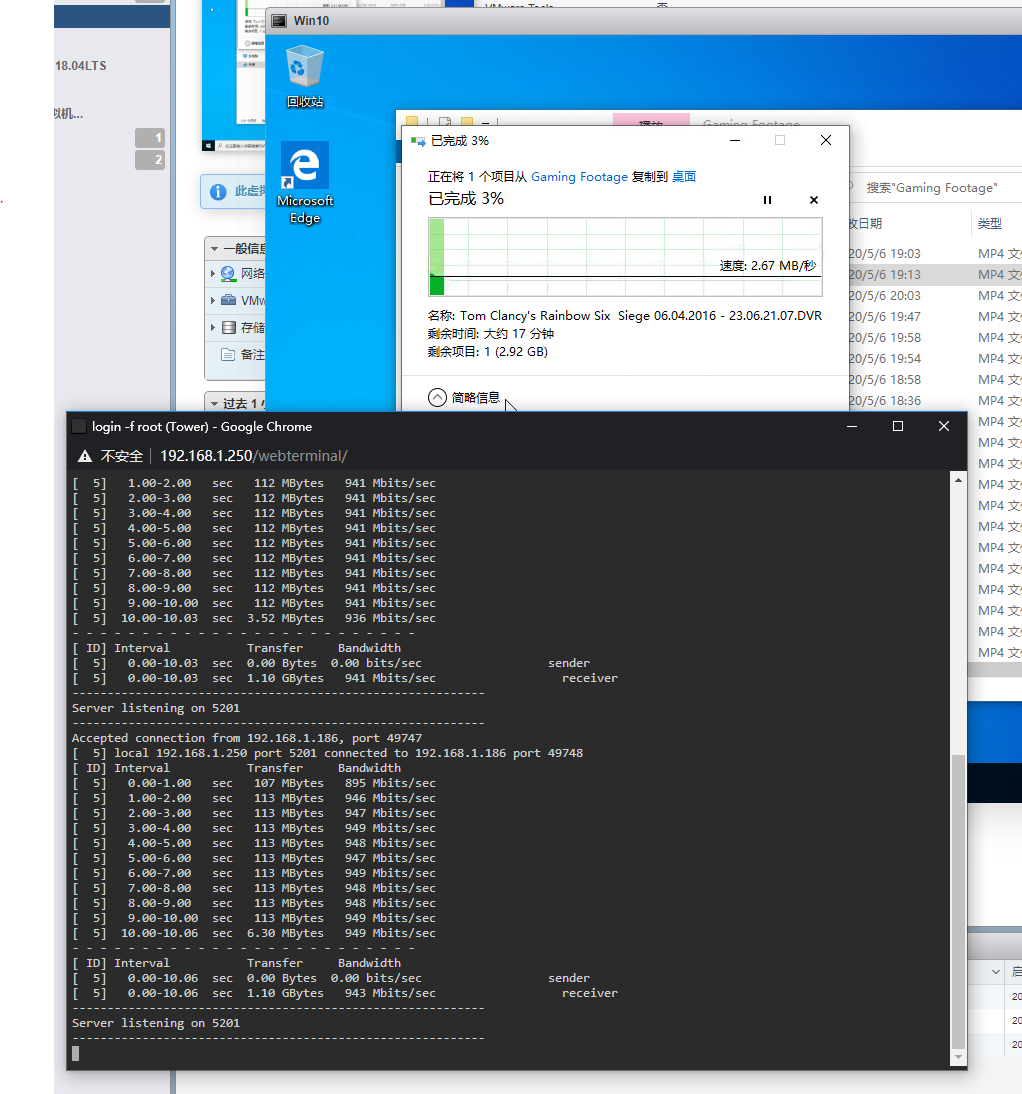

I've tried several methods to write to the shared folder which had it's cache enabled. No matter what I try, the speed would just hold at around 15MB/s.
Method1: writing from my desktop PC's 960EVO, single file over 7GB
Method2: writing from my Synology DS918+, which normally would exceed 100MB/s when write/read from my desktop, single file of 4GB
Method3: writing from a VM on my router (Win10), single file over 7GB

So I changed it to nto use the cache, the speed dropped down to between 5-8MB/s...
This suggests a network problem, run an iperf test (single stream).
23 minutes ago, johnnie.black said:
This suggest a network problem, run an iperf test (single stream).
I've ran iperf on both my VM on router and my desktop. Sincee my desktop is relying on wifi right now, the iperf result is about 50Mbit/s.
However, with the VM on router, even with the iperf result of 944Mbit/s, the copy speed is still hanging around 5MB/s.
Anything else that may be the problem? Does SMB share set to public has any effect on performance?

Thank you so much for the help. For some reason, my ASUS AC5300 router talk to the Synology NAS at 100Mb/s... Unplug and plug back in the cable solved the problem.
Again thanks. Have a good one :)
