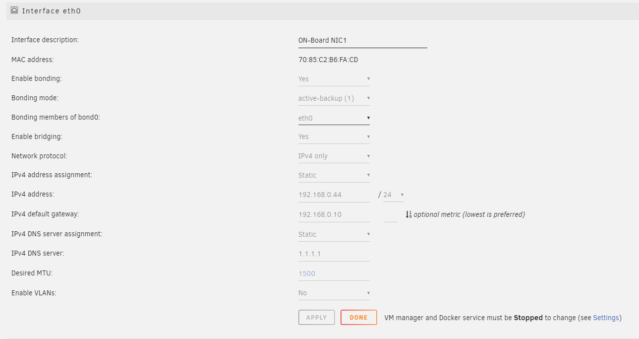

Here are the two unraid server network configs
This is unraid1, I have tried static and dhcp
this is unraid2
Many thanks for looking 🙂
