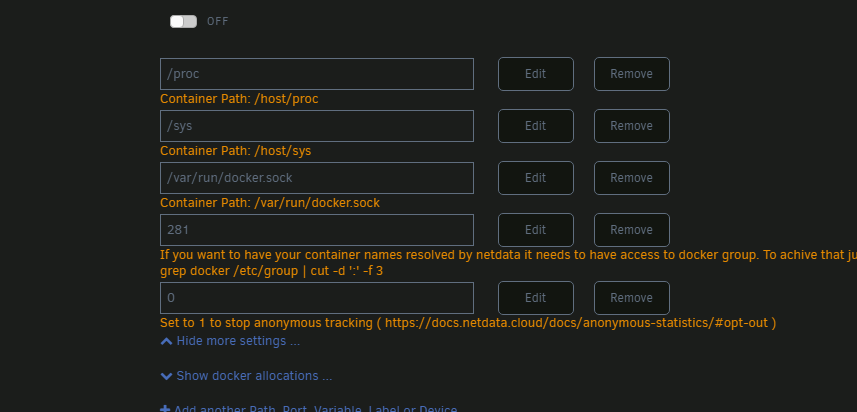

Install the netdata docker and take a look at the template variables, including what you see when you press the Edit buttons.  Some of the system variables are defined read-only.
Hmmm not sure what you mean, so I already had netdata, but there's nothing in vars in template that'd make me think "I'll just copy this and it'll work"
