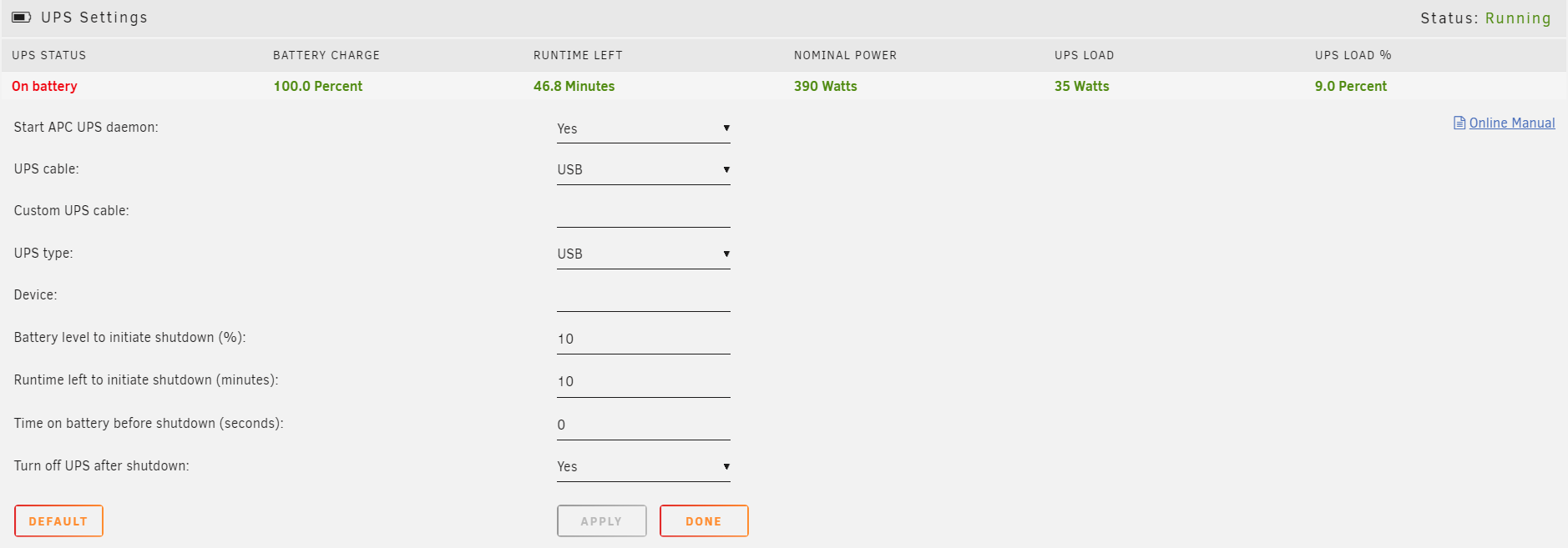

below is the UPS settings page :
image.thumb.png.8b13d054d4de2f9123b3fdf71ef6a030.pngimage.thumb.png.8b13d054d4de2f9123b3fdf71ef6a030.png

35 minutes ago, Squid said:
Try playing with the UPS type / cable type.
Yes,I have try each options,just usb type is work,but still show on battery status
