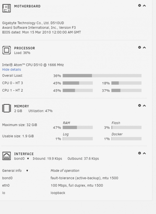

In terms of hardware this is what I got:
image.thumb.png.f251504177dfb296368a3659defcf5c7.pngI
2G RAM is pretty much the minimum now, and will only support basic NAS functionality. So can you access your data?
