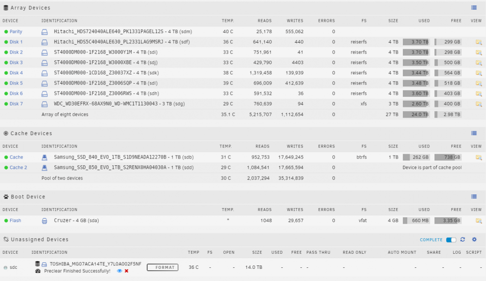

After running unRaid since v4 with no parity issues or other problems I decided it was time for some maintenance and upgrades.  All my drives were still reiserfs and I was getting tight on room.  I bought 2 14 TB Toshiba drives off eBay and ran them through the pre-clear to test them.  One failed and sent to Toshiba (where it is stuck because they  have no replacements).  The "good" one was to be my new parity drive.  I did a parity check with 0 errors.  I powered down the server, replaced my Hitachi 4TB with my 14TB Toshiba and let it rebuild.  All good.  Took old parity and pre-cleared and formated it to XFS and added it to the array.  I started moving data to empty drives using MC and Krusader, then reformatting from reiserfs to XFS.  I am getting parity errors in the high hundreds while moving files.  I am wondering if anyone has any ideas and what I should do.  I am attaching system log and screen shot of setup.
Thanks
Joe
