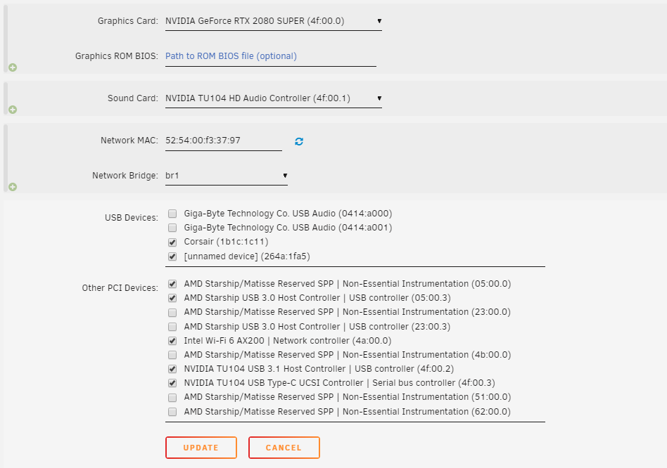

USB Pass-through to VM crashes Unraid
I am having an issue passing USB Controllers into a Windows 10 VM in Unraid on a Gigabyte TRX40 Auros Master with a Threadripper 3960x. The VM works great if i passthrough the built in Intel WiFi on the board, as well as the USB controller built into the 2080 Super that i have attached. I even tested connecting a USB-C drive to the GPU and it worked great. The problem is as soon as i pass one of the Motherboard USB controllers into the Windows 10 VM it crashes the whole server on VM startup. I have to power cycle it before it comes back. I have tried directly editing the XML as well as adding the following line into the syslinux.cfg file:
append iommu=pt vfio-pci.ids=1022:148c,10de:1ad8,10de:1ad9,8086:2723,1022:1485 pcie_acs_override=downstream,multifunction vfio_iommu_type1.allow_unsafe_interrupts=1 initrd=/bzroot
Adding these things into the syslinux.cfg file allowed me to see the devices in the VM edit GUI and select them. Everything else works other than the USB controllers. I have attached my Log Files, my IOMMU groups, the VM XML AFTER i have selected the devices i want to passthrough, as well as a screenshot of the VM configuration in the GUI since i did all my config through that instead of editing the XML.
I really hope you guys can help me, i have been trying to figure this out all day and i finally am out of ideas and i cant find a solution anywhere in the forum or reddit.

<domain type='kvm'>
  <name>Primary Desktop</name>
  <uuid>e514c502-6575-64b6-7ff9-7d41d771aec0</uuid>
  <metadata>
  </metadata>
  <memory unit='KiB'>33030144</memory>
  <currentMemory unit='KiB'>33030144</currentMemory>
  <memoryBacking>
    <nosharepages/>
  </memoryBacking>
  <vcpu placement='static'>24</vcpu>
  <cputune>
    <vcpupin vcpu='0' cpuset='12'/>
    <vcpupin vcpu='1' cpuset='36'/>
    <vcpupin vcpu='2' cpuset='13'/>
    <vcpupin vcpu='3' cpuset='37'/>
    <vcpupin vcpu='4' cpuset='14'/>
    <vcpupin vcpu='5' cpuset='38'/>
    <vcpupin vcpu='6' cpuset='15'/>
    <vcpupin vcpu='7' cpuset='39'/>
    <vcpupin vcpu='8' cpuset='16'/>
    <vcpupin vcpu='9' cpuset='40'/>
    <vcpupin vcpu='10' cpuset='17'/>
    <vcpupin vcpu='11' cpuset='41'/>
    <vcpupin vcpu='12' cpuset='18'/>
    <vcpupin vcpu='13' cpuset='42'/>
    <vcpupin vcpu='14' cpuset='19'/>
    <vcpupin vcpu='15' cpuset='43'/>
    <vcpupin vcpu='16' cpuset='20'/>
    <vcpupin vcpu='17' cpuset='44'/>
    <vcpupin vcpu='18' cpuset='21'/>
    <vcpupin vcpu='19' cpuset='45'/>
    <vcpupin vcpu='20' cpuset='22'/>
    <vcpupin vcpu='21' cpuset='46'/>
    <vcpupin vcpu='22' cpuset='23'/>
    <vcpupin vcpu='23' cpuset='47'/>
  </cputune>
  <os>
    <type arch='x86_64' machine='pc-i440fx-4.2'>hvm</type>
    <nvram>/etc/libvirt/qemu/nvram/e514c502-6575-64b6-7ff9-7d41d771aec0_VARS-pure-efi.fd</nvram>

Update on this:
When Unraid crashes after trying to start the VM it usually changes the "Enable VMs" option to NO. I then have to go in and enable that setting again.
Currently trying to work with the VFIO-PCI CFG plugin to get it to work. No luck yet.
Hi there,
I'm sorry to hear you're having problems with pass through of the USB controller, but unfortunately AMD hardware is notorious for having issues with pass through in general, and this looks to be just another example of that.  My suggestion would be to purchase an additional USB controller that can install into another PCI slot on the system and use that for pass through instead.
All the best,
Jon
@Sgt.Ogre  45:00.0 USB controller: ASMedia Technology Inc. ASM2142 USB 3.1 Host Controller works okay for me without ACS patch.
A spare USB card is probably the easiest as option as Per @jonp comment but it would be a pity with 5 USB controllers to only be able to use one. In the current version of unraid trying to get the starship or onboard audio to work increases in complexity...
Generally everyone is getting this:
"There are 2 USB roots on the CPU and 2 on the chipset. The ones on the chipset are in the same IOMMU group and also contain the wifi, bluetooth, and audio. No passing those through without major cost. The ones on the CPU cannot for now be passed through: this hangs the entire system. That's not just me, I have seen a number of other people comment on that. In effect, from what I have seen, there currently is no viable native USB passthrough on trx40."
https://i.reddit.com/r/VFIO/comments/f2m1i4/some_trx40_observations/
Chipset USB:
Different mainboard (Zenith II) but "Passing through the Matisse controllers (after ACS) works perfectly. No errors and you can just plug / unplug things, and one of them is connected to half of the backplate usb I/O." - so might be worth a shot but I wouldnt hold out much hope on this one.
https://forum.level1techs.com/t/anyone-looked-at-trx40-iommu-groups-and-passthrough-yet/150596/30
CPU USB:
(there be dragons)
Some hope about using FLR patch on Starship CPU based USB controllers (and for onboard audio) in unraid. But you will want to do a lot of reading I think. Involves a custom kernel TRX40 Aorus Extreme user post : https://forums.unraid.net/topic/82625-kernelcustom-kernel-build-with-treaks-20200307-v683558419108naviveganfsv4r8125zen2/?do=findComment&comment=849084
Ref to problem and workaround: https://www.reddit.com/r/VFIO/comments/eba5mh/workaround_patch_for_passing_through_usb_and/?ref_source=embed&ref=share
Unraid custom kernel link - https://forums.unraid.net/topic/82625-kernelcustom-kernel-build-with-treaks-20200307-v683558419108naviveganfsv4r8125zen2/page/6/
Edited by Cadal
