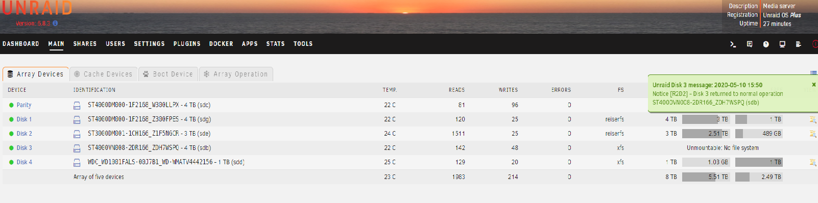

I recently had a 3TB drive fail , and I replaced it with a 4TB drive.  I performed the preclear on the drive and then added the drive to the array and it performed the rebuild.
The array shows online with no errors.  The shares are not reporting any errors, but when on the main page I see Unmountable: No file system instead of the drive size and used details.
I am not sure what details are important to investigate/resolve this issue.
I am using Unraid Version 6.8.3
If more details are required to investigate, please advise what I need to include.
Thank you

I suspect the ‘emulated’ disk was showing as unmountable before doing the rebuild?    The rebuild process does not fix file system corruption - you need to follow the procedure shown here in the online documentation to fix file system level corruption.
