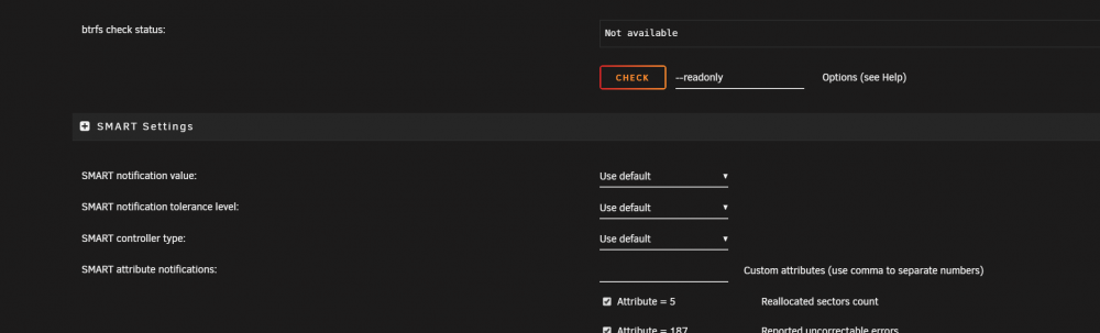

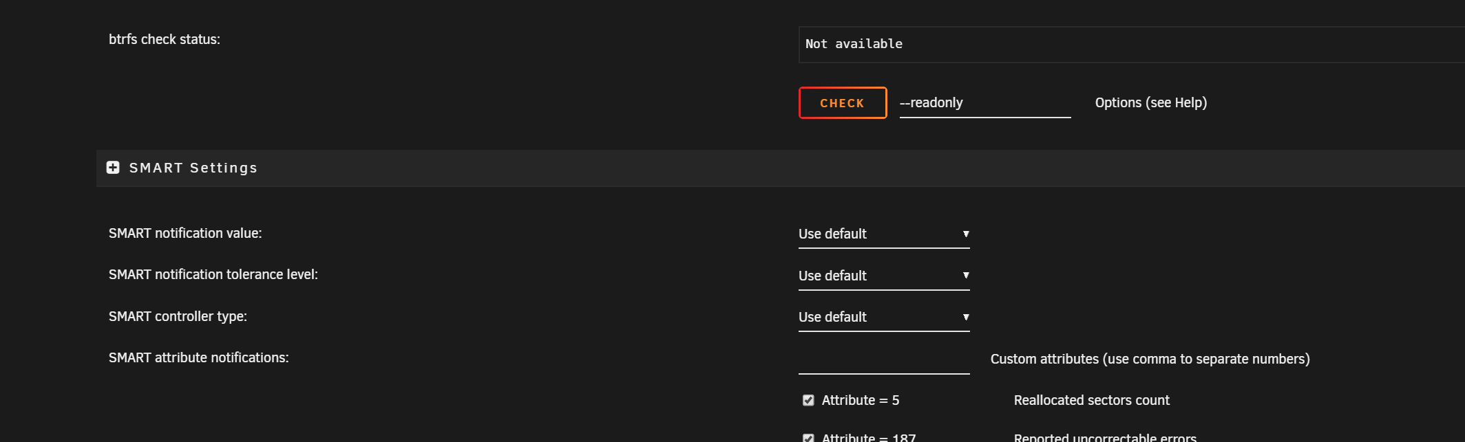

i cant find what /dev/mdx    be for that hard drive
but i now have option under the drive
is it ok to change readonly to repair ?  is that what you would type in..  i not hitting enter or nothing as its still doing its check  should be done maybe midnight tonight its at 37 percent complete
Edited by comet424

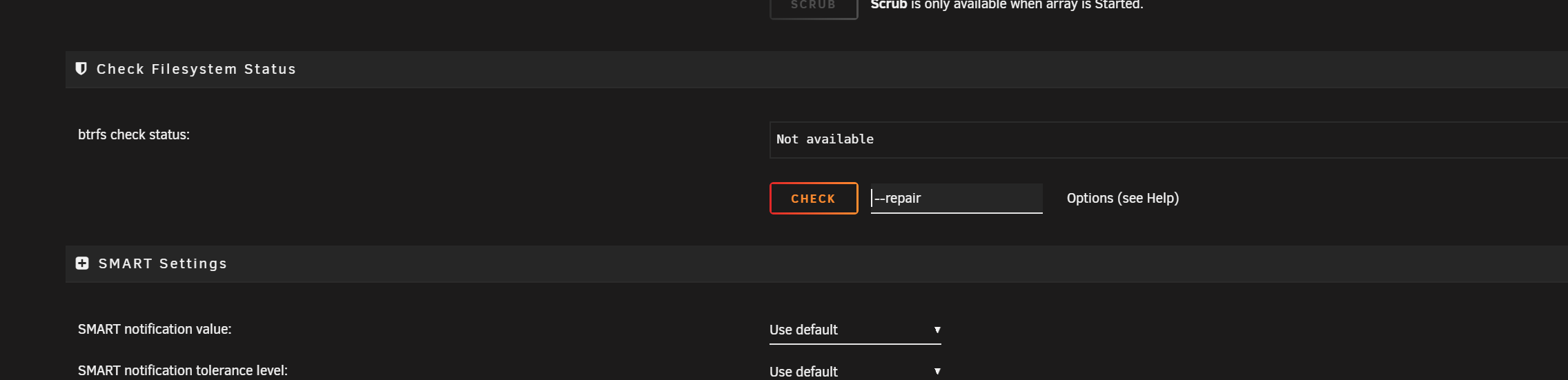

and would you kn ow about the --repair i posted if that would work  the check  says i have 13 hours more to go anyways   so i got time for input
Very unlikely for check --repair to work for this, and it might makes things worse.
ah ok  what does the check --repair actually do  as it said  if your in an array to do the --repair

15 hours ago, comet424 said:
parent transid verify failed on 1543279591424 wanted 136563 found 130890
This means some writes were lost to the device, and it's usually a fatal error.

@JorgeB
so does that mean its un mountable?  as the commands to for a mount in read only does nothing...
does it say  from that ata info    if its the hard drive? it passes smart ..    is it cuz im running btrfs?
what link resets  can lead to lost writes..

ah  ok ya that restore doesnt work  least it doesnt work now  i rebooted again and says
er:~# mount -o degraded,rescue=all,ro /dev/sde1 /mnt/user/restore
mount: /mnt/user/restore: wrong fs type, bad option, bad superblock on /dev/sde1, missing codepage or helper program, or other error.
root@mitchsserver:~# ^C
i have a folder.  called restore.. but why is the wrong fs type?  or is it saying it could be any of these..  someone from the discord  thinks maybe its a superblock?
You're not doing it right, btrfs restore is done without mounting the fs, it's option #2 in the link.

root@mitchsserver:~# btrfs restore -vi /dev/sdd1 /mnt/user/restore
Ignoring transid failure
ERROR: root [1 0] level 1 does not match 0
Couldn't read tree root
Could not open root, trying backup super

guessing its fatal nothing recover.. those command lines dont work after multiple reboots  and no ata issues now.. so  guess the fs is gone..
well i gave it a shot
The fs was already gone, but sometimes btrfs restore works for this issue, sometimes it doesn't, and in this case it didn't, time to restore from backups if available.
