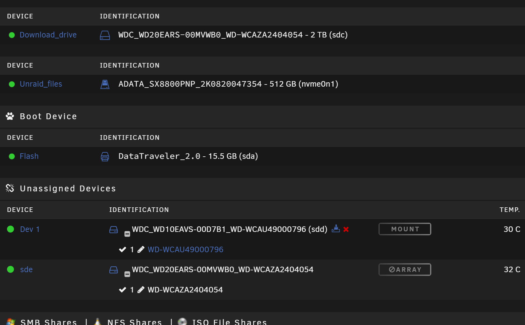

my 1 harddrive Lost its File System (unmountable)
ya i got some backups...  ya didnt help this time.. what is a backup super?  since it said to use it in the error above  as i thought root was the highest?
so i got a spare drive  in the 4 bay case...  i added the drive as a cache pool..  reason is my sister not home to swap drives  in hot swap
so i set it to a xfs  file system...    so hopefully its more flexable it doesnt happen again..  but be nice like  i mentioned if they did offer a notification for these type of errors  that doesnt show up in the regular notification options
Btrfs restore already looks for super backups, but likely all the superblocks will have the same problem in this case.
oh so a superblock is like a backup of a file or something that a super backup does..
does this also happen possible for the array too?
right now its a 8tb set to btrfs... can it fall to this same scenario that the download pool happened
and should i switch to xfs   or shove a 8tb drive in for parity    and than that solves it?

on top of what i said above.. i dont understand  why  the cache drive i using   is also in the un assigned drives?  its part of the array    the one that says mount is the bad drive the ata5 issues
is that normal for the pool drives to show up in the unassigned devices section?

so something going wrong with her server.  the download drive went into read only...  the shares page  says no exportable shares... but the array shows one drive shows files
before i do a reboot.. i downloaed the diagnostics... i dont wanna reboot.. but does it say  the array is in trouble..
it has to be  either power supply or back plain of the board...   cuz it was just idling and stuff.. was re setting it up..
think its time to change case  and not use it till i fix it i think
so it has to be power supply or backplaine as it not hard drive.. if its affecting the other hard drive...  but maybe you understand the error codes better then me
so i know what i need to do
mitchsserver-diagnostics-20220703-1620.zip
Looks like your download_drive was sdc when array started but disconnected and reconnected as sde, so it isn't assigned.
It also has 22 pending sectors. You should see SMART warnings for that disk on the Dashboard page, and you should have gotten notifications for it.
You should replace the drive, doesn't look like it has much if anything on it.

and the showing in unassigned devices.. happens right after reboot...
SMART isnt working  its showing blank info when i either click    "sde"  or "download_drive"  so ill give the computer another rebooted
so if it was sdc  at bootup and array starting    then disconnected and reconnected  would that be a backplain  or power issue?  or could be both.... going to reboot it..

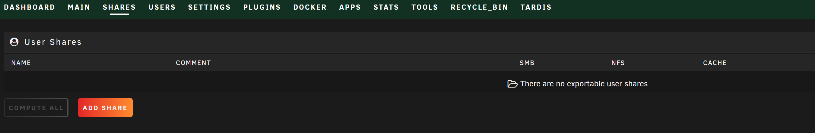

starts off with 1 issue  then 2nd hard drive having this issue..   just waiting for the 3rd thing to go lol
shares are back after a reboot..
