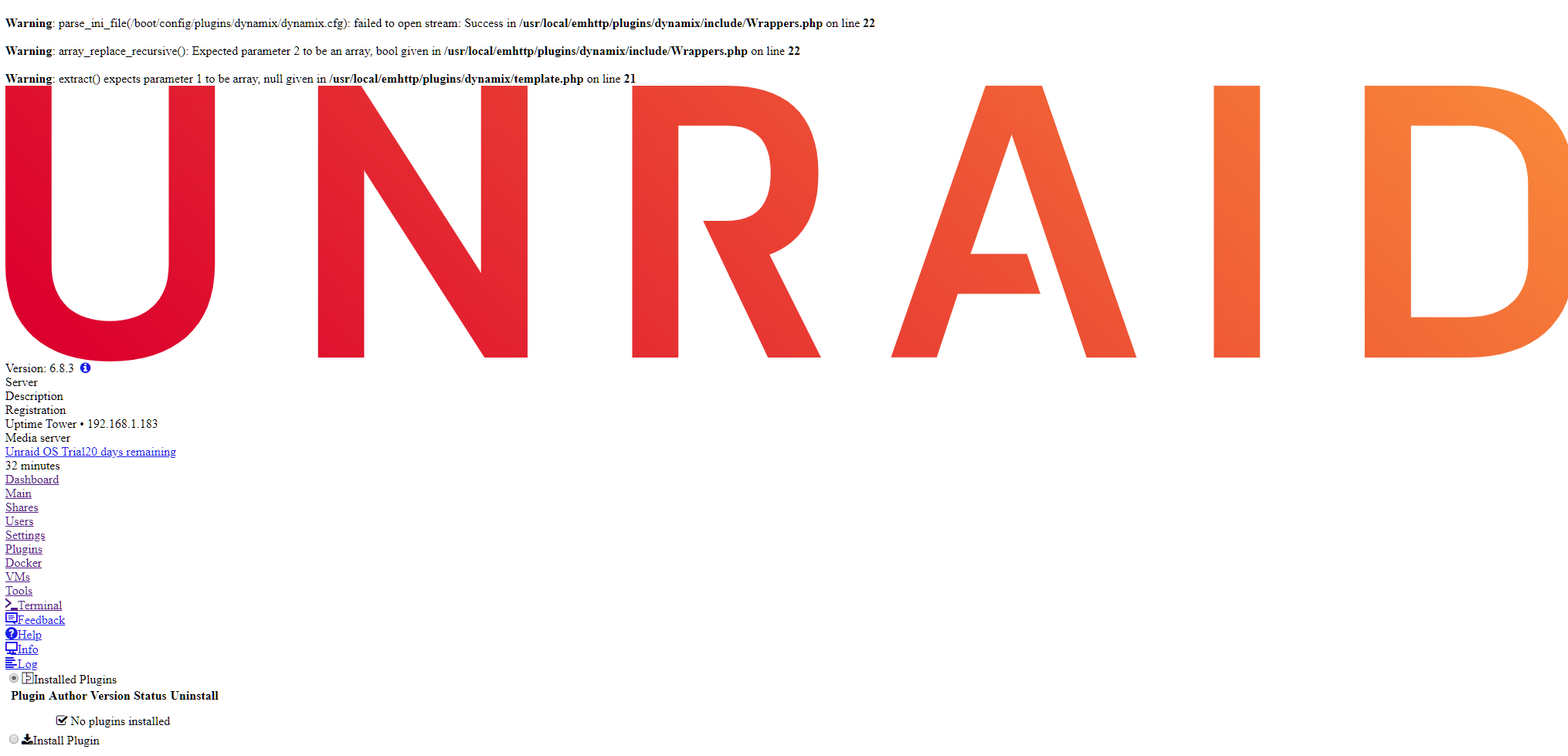

So far, I have two drives in the array that I have moved most of my data to. I was about ready to turn on parity and add my old drives to the array. I installed binhex-preclear via the community plugin and all of a sudden, my webui is foobar.
I've tried safemode with no dice. I had not backed up my USB config yet, and I was able to uninstall the binhex-preclear plugin. Is there a way to refresh the webui, but keep everything else in place?
Looks like your Unraid flash drive has disconnected. Put it in your PC and let it checkdisk. While there make a backup. Be sure to boot from a USB2 port.

Uninstalled via the web interface (was able to click on the icon then remove). Then I removed the directory /boot/config/plugins/dynamix/dynamix.cfg/
