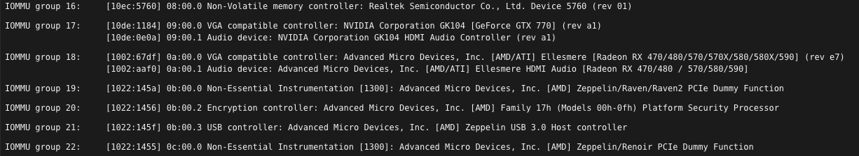

So your first step is to try to get your passthrough device in its own IOMMU group. There's no point trying to stub it until you get this far. You're looking for a neat arrangement something like this;
You need to play with ACS settings, Bios settings etc. until you achieve this.  Only then can you start stubbing.
Of course, it's entirely possible that your MB does not support this and then you're stuck.
If you do manage to get your device in its own group, please post a fresh listing of your IOMMU groupings and we can take it from there.
