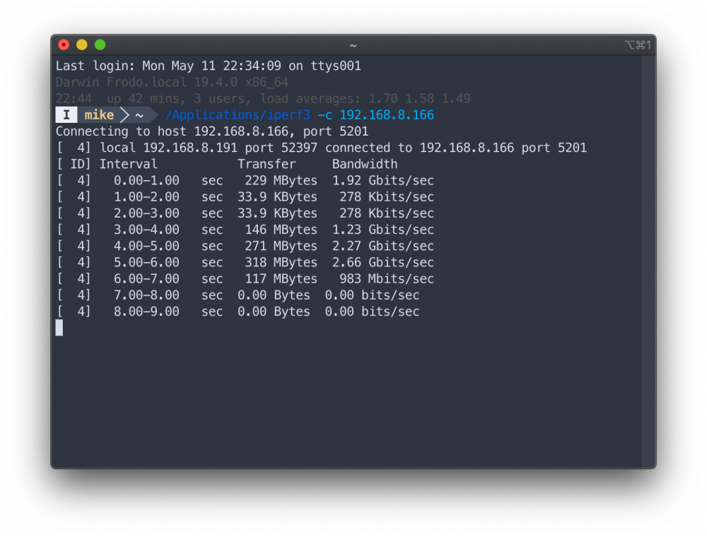

Hey,
I am hoping to get some answers here, I recently got the HP NC523SFP and installed it into my server. The first thing I tested is an iperf run but the network crashed (see screenshot) and the server was unresponsive. I have tried restarting, resetting the network config, using different cables and ports on my switch (MikroTik) but nothing works.
I realized that it 'firmware hang detected' pops up in the log. Is there something wrong with the card? Do I need to return it? I attached the diagnstics.
I really appreciate any help.
