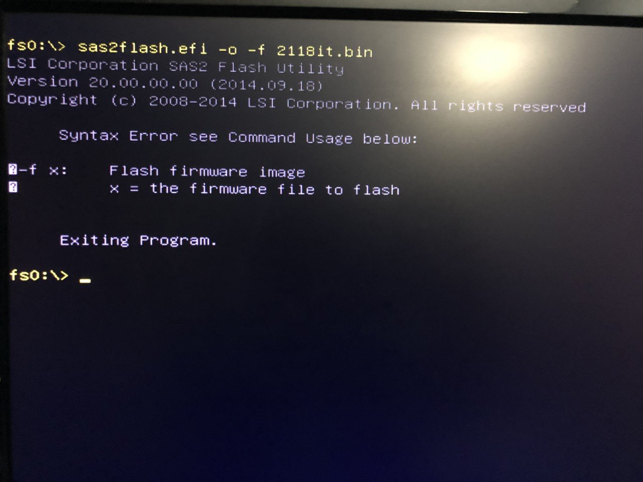

I bought a LSI 9211-8i and I've been trying to flash it using my x79 motherboard, and following a few guides like the ones below:

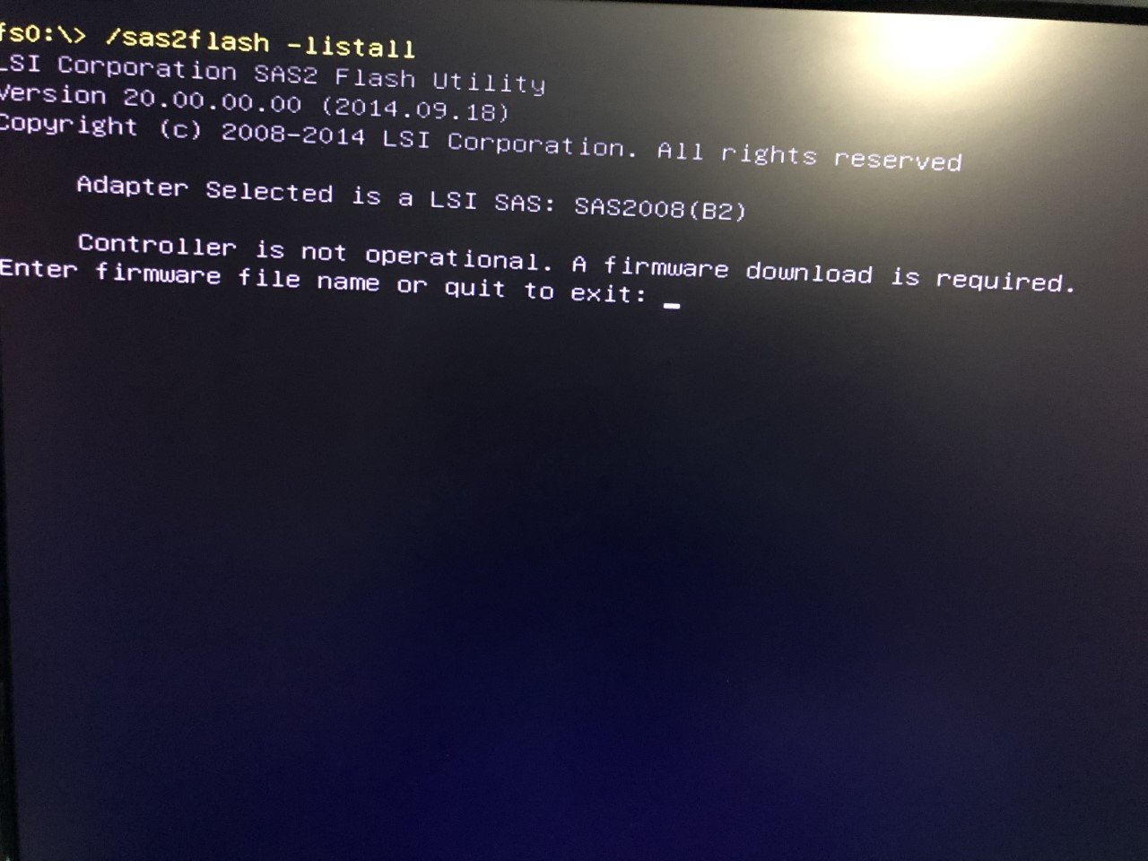

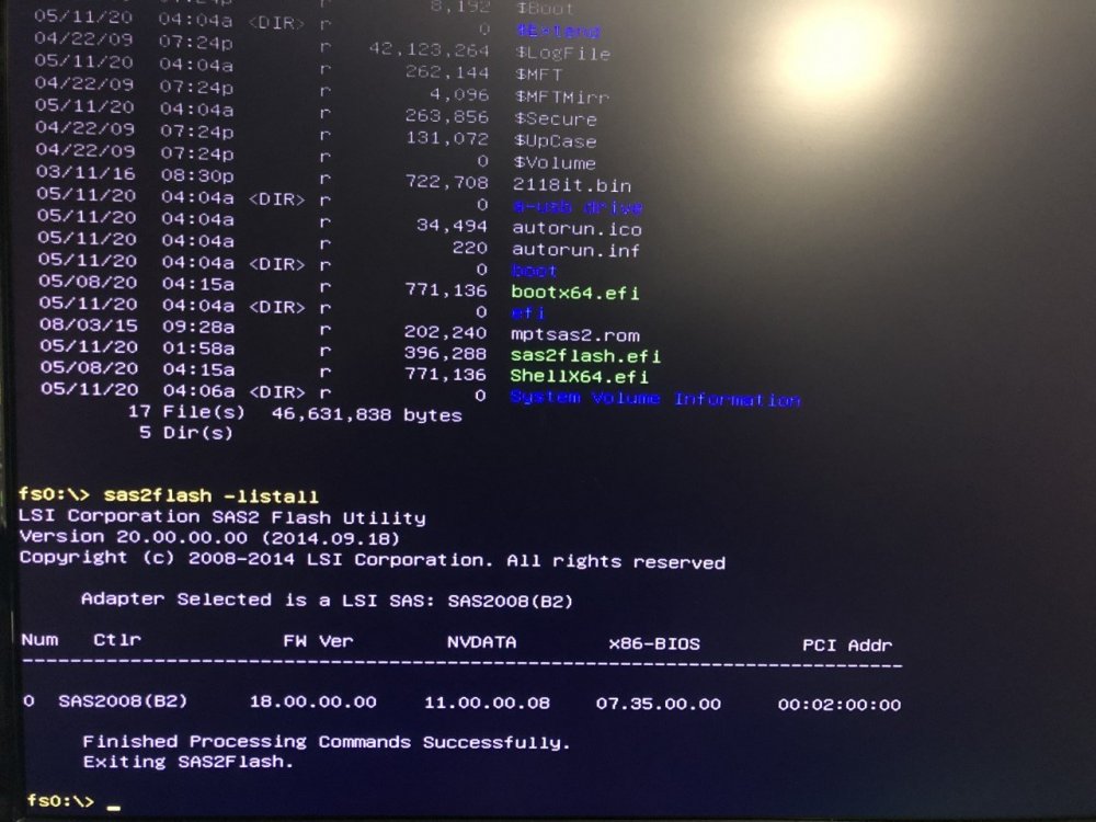

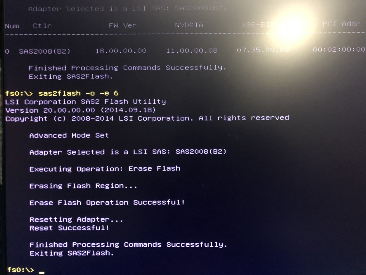

The one that got me the farthest is the last one as I have to use UEFI. I've gotten all the way till the "fs0:/> sas2flash.efi -o -e 6" command; However, the "sas2flash.efi -o -f 2118ir.bin" (I'm not trying to install the .rom) isn't working. Even if I do it with the full "sas2flash.efi -o -f 2118ir.bin -b mptsas2.rom" command. I have my server up and can't turn it off as it will brick the card. Please advice what I should do here. Another question, which card is better for unraid and/oir overall, the SAS 9207-8i already flashed to IT or the LSI 9211-8i?
I also get this after I try to do these other things...
Won't brick, does any hidden character in command, it show syntax error.
Pls try flash bios then firmware individual.
I have tried using a different keyboard, and changing the flash file to "it.bin" in case the issue was being caused by being too long or by the numbers and no luck. I've also try to use 'sas2flash.efi -o -f it.bin' and 'sas2flash.efi -o -b mptsas2.rom'. I still get the syntax error. Any other suggestions?
May be you could try -o -e 7, but this will clear SASaddress too, you just need to set any address later or found the address on label.
Isn't the address something that is set after the firmware update? I kinda don't wanna keep trying to remove stuff from it but at this point I guess I'll try it.
If this doesn't work out I may try the SAS 9207-8i as it appears to come pre-flashed to IT. However, I would like to know which card is better for unraid and/or overall, the SAS 9207-8i or the LSI 9211-8i?

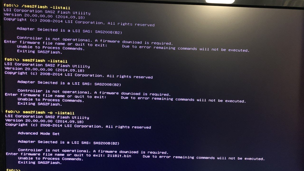

This is not working. It is asking that a firmware hostboot is required, and to enter one. I try entering the file name for the firmware and it throws an error.
"selected adapter does not have valid firmware! Please run utility again and flash firmware.
due to error remaining commands will not be executed.
Unable to process commands.
exiting sas2flash."
Tried flashing again, and no dice.
No much different as both are 6Gbps / SAS2, mainly different are PCIe interface 2.0 or 3.0 ( 5GT / 8GT )
exiting sas2flash."
Some error still uncertain and fix, I try -o 6 or 7 on several HBA ( chips 2008 / 2308 ) also no problem. If possible, pls try on other mainboard.

@BensonYea, after the first 'sas2flash.efi -o -e 6' nothing has actually worked after that, other than 'sas2flash.efi -listall' to see it.
I literally been on this for about a week now and I'm done with this card. I bought and installed a LSI Logic SAS 9207-8i and is currently in FW Revision 18, already in IT mode. It did cost me $20 more; However the original is still within the return time frame so I will be returning it. I don't know about you, but when its been over a week and someone still can't flash a firmware, I would go ahead and call that defective.

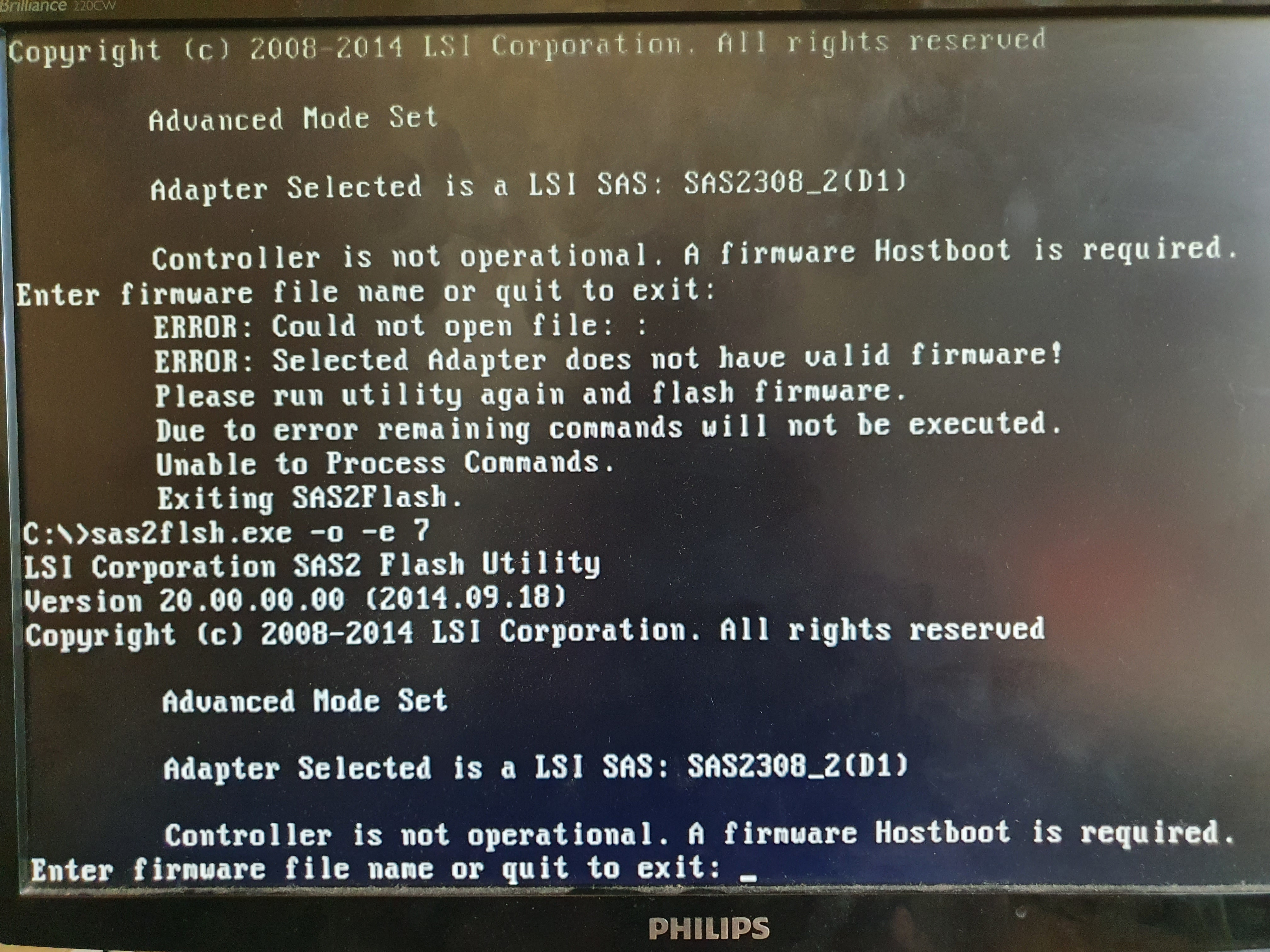

This is my first post, and before that I read everything I managed to find on this forum related to LSI 9217-8i flash to IT mode. And tried all the proposed options, where others have already reported that they have successfully performed the procedure.
I used the motherboard:
- HP Z420
- Asrock h55m-le
I get the same result regardless of whether the usb boot is in legacy or uefi mode.
The first command sas2flash.exe -o -e 7 or sas2flash.exe -list or sas2flash.exe -listall get the same result.20210508_101512.thumb.jpg.c8cb1a7d7167e52d5547b748e8cf25c1.jpg
I would ask for advice on what I am doing wrong or where I am doing something wrong.
