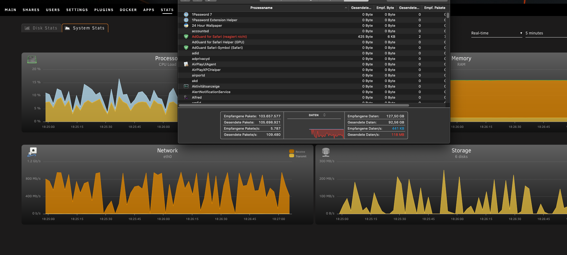

I attached a screen where you also see the macOS activity monitor validating this worse transfer rate.

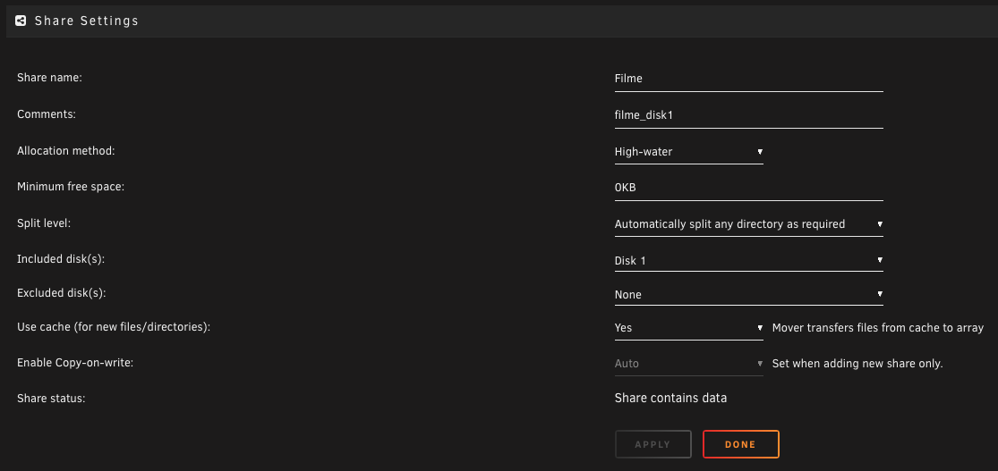

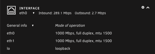

Share- and Network-Settings also attached.

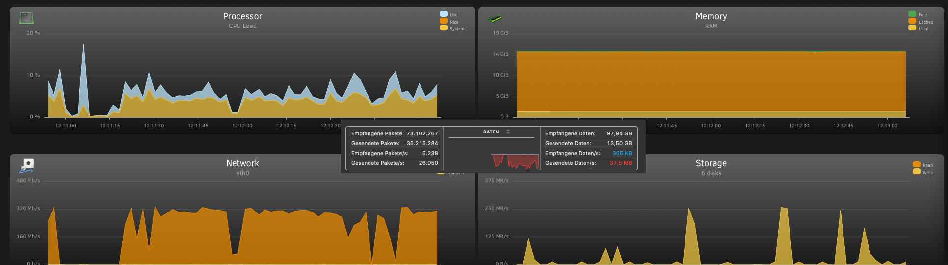

But it seems, that the problem is gone --- I made some more big file transfers to the same share "filme" and got the expected speed of 100MB/s - 118MB/s in peak!!
See screenshots attached. I'll review this at any following transfer and give a feedback.
