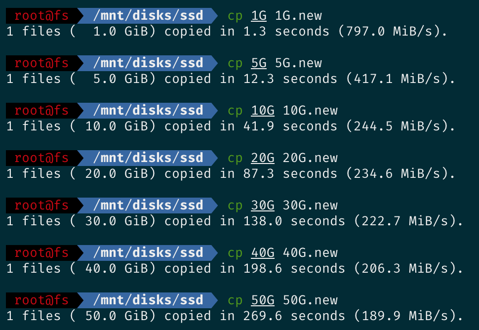

I haven't been able to reproduce the very slow speeds yet but you can see the extent of thermal throttling for short bursts of writes here:
You're copying from/to the same device, that's not a good way to test.
