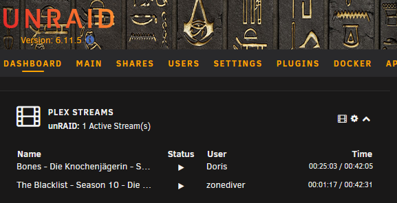

Just an additional "small" error:
2 active streams (two users), but only "unRAID: 1 Active Stream(s)"
Edited by Zonediver
Hmmm, ok let me dig into this...

26 minutes ago, Zonediver said:
Can you do me a favor and go back to the settings page, and click save, and then tell me if its displaying both streams on the dashboard widget.  Once I added the 2nd server and hit save it then showed up on the dashboard widget.image.png.0c5d6c438bcb70d01d9369b7fa0ceac7.png
But I am also just putting together a release as the counts always seem to stay at 1, so there will be a release shortly to correct that.
and another update is out there to fix incorrect stream count for dashboard widget
Working now - thanks 👍

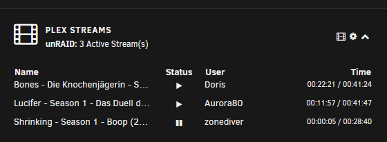

I miss something (suggestion)...
The plugin shows the time of each stream on the dashboard - so far so good...
But what's missing is the "endtime" of a stream. The lenght of the stream is not really interesting, but when it ends would be nice to see 👍
Maybe in a future release? 😉
Added for unRAID 6.12rc2+ in today's release, it should show in the dashboard widget
