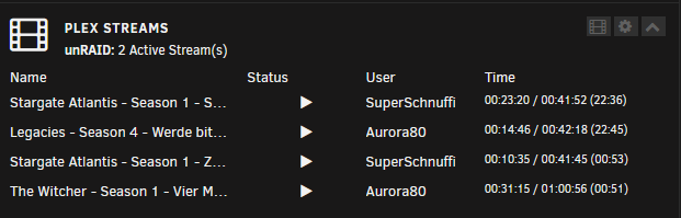

On 6/30/2023 at 3:23 PM, Zonediver said:
Well... i think, there is an other problem...
I saw this several times today...
It seems the plugin did not delete played streams...
Two active streams but four shown 😉
I am / have been encountering this as well....
Unraid 6.12.3 using plex streams version 2023.06.29 on Firefox.
When I hit refresh, it will update and pull correct current streams, however, I keep having to refresh the page for it to remove the played lines.
Typically seeing duplicate streams is because there is a configuration setting wrong.  Please make sure you do not have servers selected in the servers list as well as populated in the Customer Servers field.
Yes, there are no servers selected and the custom server field is filled in.
The issue is not a duplicate stream.. rather the old streams that are finished playing don't get cleared off from the list and so when the next stream plays, the list just gets longer.
When you refresh the page, then the old streams get cleared off.
As a note, this was not an issue on 6.11 but I've started encountering this on 6.12.3 after I upgraded.
ok now that I know how to re-create it I can look into it.  There was a bunch of changes in moving from unraid 6.12 for this plugin, so somthing probably got a little messy.  I'll try to get it correct in the next week or two.

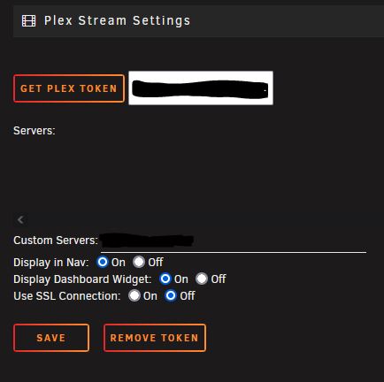

What version of unraid are you running.  Also can you post a screenshot of your Plex Stream Settings page, blur out anything sensitive
Edited by dorgan
Typo
I'm on unraid 6.9.2 and here is the screenshot. It looks different than some settings pages I've seen in this thread, not sure why.

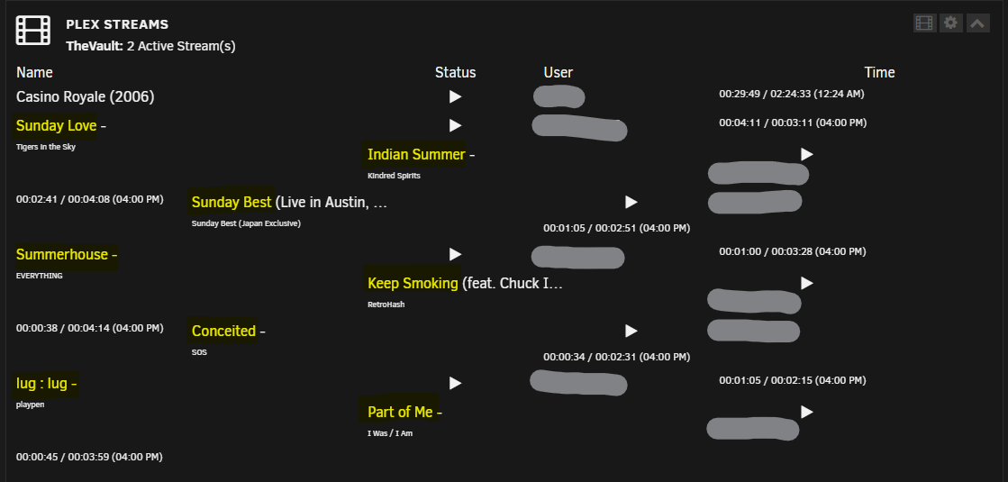

Not sure where/how to report this error but there seems to be an issue with how the plugin represents music streams. It almost seems like it's storing the information as an array and somehow the music streams add an empty entry that moves all the content over one column's worth? Add that with not clearing done/ended music streams as it reaches the next song and you get this behavior in the UI (song names highlighted):
Happy to provide any extra info if it would help with debugging! Other than this the plugin has been great, appreciate it!
EDIT: Additional info: everything is fixed on a page reload and I'm using the Brave browser, Unraid 6.12.8, and the latest plugin version 2023.11.27

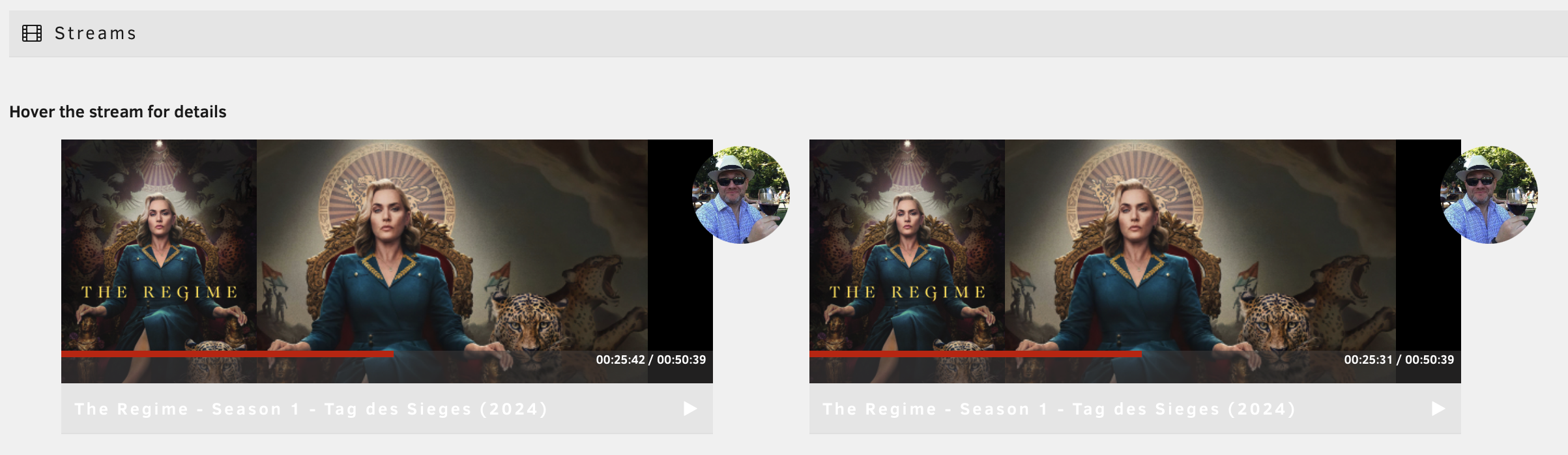

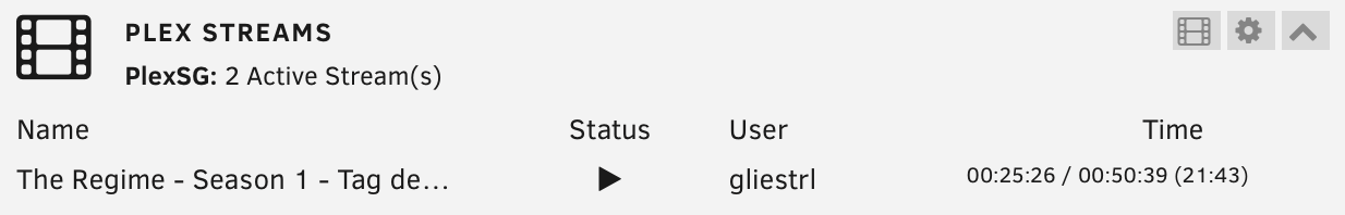

Any clue why Plex Streams shows the one stream twice?
1634442266_Screenshot2024-03-27at21_18_33.thumb.png.a1e4453aba248beab9fc370073902394.png
153418846_Screenshot2024-03-27at21_18_47.thumb.png.fa75ae7c70a6d0bf714040c92032c8bb.png
Check your settings, if you already have a server selected in the list, you do not need to fill it in inside the custom servers field.
@dorgan that was an easy fix for a stupid error on my Side ;) Thx again!
