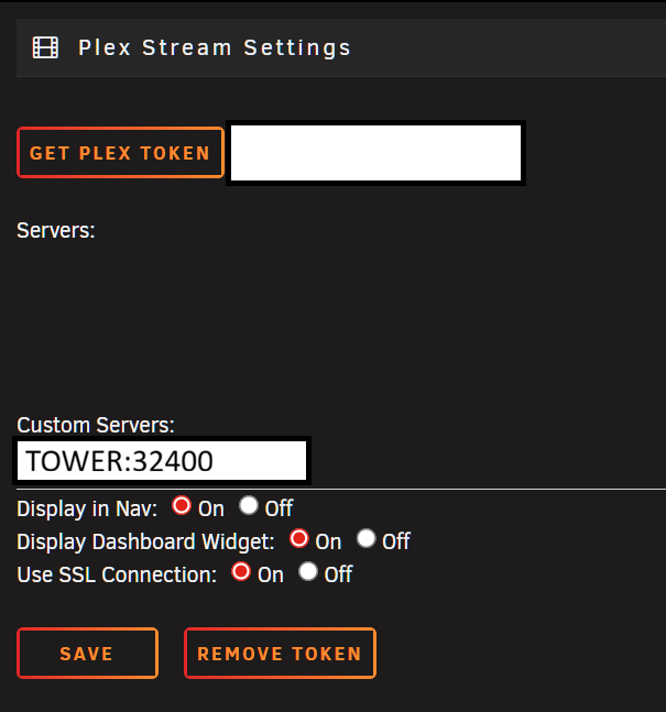

For those of you having issues, is your plex instance running in a container and if so what do you have the Network Type to? I believe depending on the network type the plex API has a hard time getting IP addresses. My Plex instance runs on a different machine, but when I was running it in docker, i used bridge or host and those seem to work just fine. Please let me know and I can try re-creating that locally to see if I can get it to work, but ultimately the IP address list is populated by an API call to Plex, not to your local plex instance, and if that call doesnt return a list of IP addresses then I have nothing to populate the selection list with.

I'm running Plex on the host network. Plugin will retrieve Plex token but won't ever list servers. Tried both SSL on and off. If I manually input the URL streams show on the Plex Streams page but not on Dashboard widget.
Edited by shiftylilbastrd

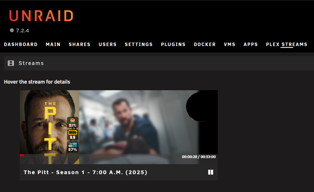

still works fine for my 7.2 server, guess ill keep it till it breaks

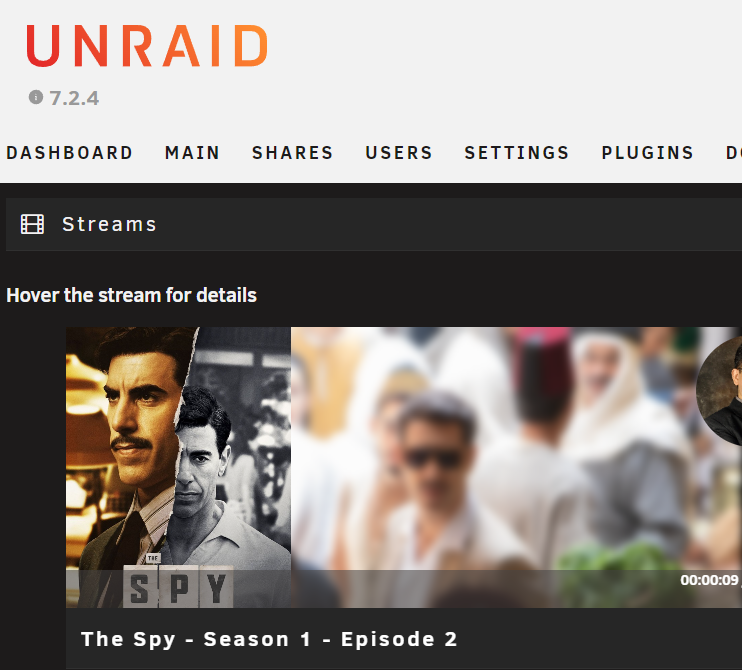

Still working for me on unraid 7.2.3 I am not really sure why some people are having problems are others arent. @Squid Not sure why this was marked as deprecated.
Still works for me on 7.2.4
1 hour ago, feins said:
What issue are you reporting?
