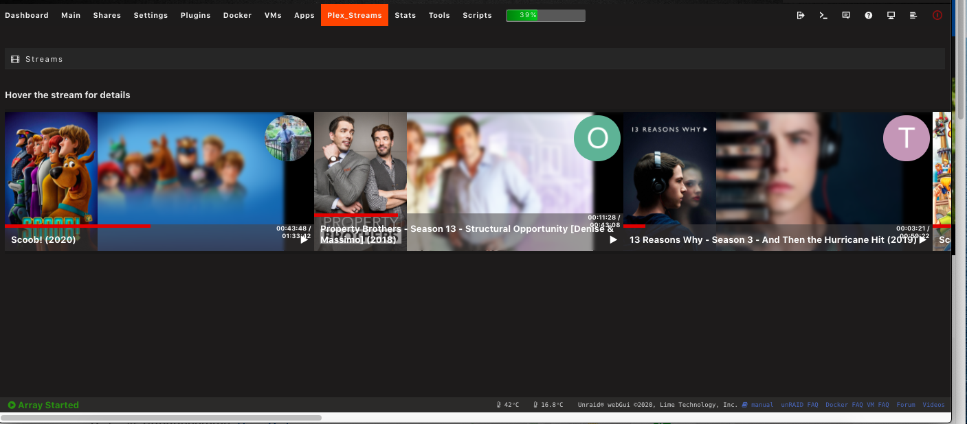

I also wonder if you can update the plugin to support dynamic arragment of the streams it only goes left to right and leaves a lot of potential space below plus scroll wheel is easier than clicking and dragging the horizontal scroll bar on the browser
(using Chrome for macOS Catalina on a MacBook Air in the screenshot below)
29 minutes ago, Can0nfan said:
Hi again @dorgan
This is a bug, should only be three streams max.  I'll look into this.
