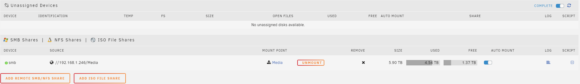

16 minutes ago, tommyhf said:
it is showing under SMB Shares. I can access the folders and files there via the "file explorer", but the folder is not showing under "Unassigned Devices" and I can not access it via Plex either
I think that screenshot means it is working. What "file explorer" are you referring to?

Thanks for the quick reply. I am referring to the "file explorer" that pops up when I press the name for the mount point folder under SMB Shares. I saw that part, but I didnt quite understand where Im supposed to enter that setting. Could you please point me in the right direction?

Warning: syntax error, unexpected '!' in Unknown on line 29 in /usr/local/emhttp/plugins/unassigned.devices/include/lib.php on line 1324 as per below.
I've been getting this error for a few weeks on the main screen.  I think it happened since passing through an NVME drive to Windows, or it could be since passing a dual port network card through to VM's.  So, when I start Windows the error (per below screenshot) actually goes away, then when I stop windows it comes back.  To this end I assume it's the NVME drive as the NIC is not passed through to that VM.

2085913036_ScreenShot2019-05-23at09_24_46.thumb.png.736aaee2f1f2eb39b3db51994d4838fa.png
I don't see the problem with the code and I can't reproduce the problem.
OK, I guess I have to live with it.  It doesn't seem to impact anything, just looks horrible.
